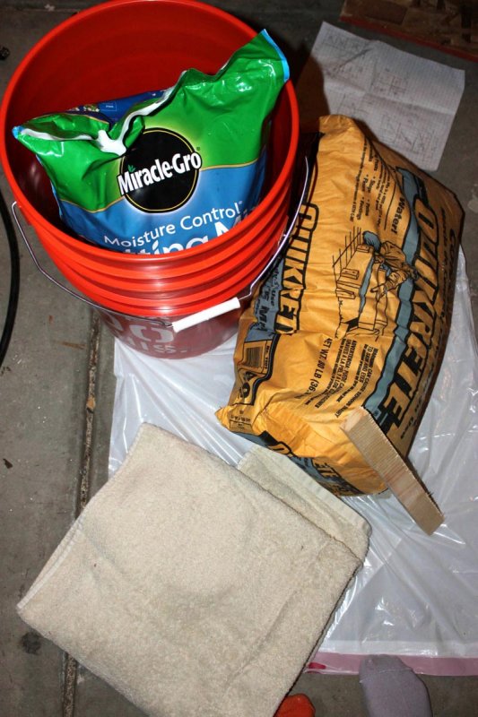

Materials needed:
– 1/2 bag of QUIKRETE
– 1 mixing stick for concrete
– water, accordingly
– 2 5-gallon buckets
– 1 towel
Take an old towel and take a second 5-gallon bucket and flip it upside down. Lay the towel over the bucket to test the length of the towel. You’ll want the ends to just be touching the ground, but you don’t want too much excess. If your towel is too long, cut some of the length off on either side. Keep measuring the towel on your bucket until you get the size you desire.

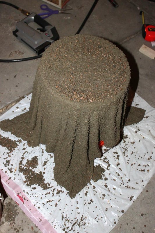

Put your towel into the concrete bucket. Keep mixing your towel around and cover every single centimeter of it in concrete. This is the most important step–my towel had a few spots not covered in concrete, and you ended up seeing those spots in the final product.
Once your entire towel is covered in the concrete slush, drape it over the upside down bucket. Move it around and make sure the sides are even and laid out how you want them to look.
If you see any bare spots, now is the time to take some concrete and patch those spots.
Let the planter dry for 24-48 hours. Once completely dry, remove the bucket from the concrete towel. (Drill two holes in the bottom of the planter for drainage.)

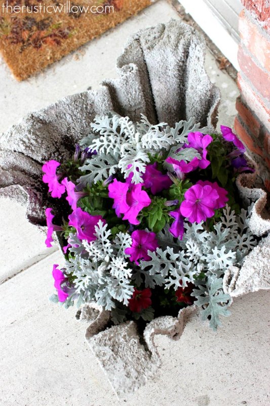

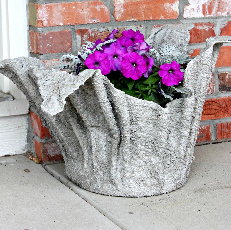

Flip the planter right-side up. Fill with soil and a plant.

That's really cute. You could use different shapes, etc., vice a bucket. Actually, even material other than a towel, so long as the concrete was totally saturated.

You could also use other objects like old shoes and make little planters out of them or even something like wicker baskets. The more porous or textured things would probably work better and allow the concrete to adhere and hold better without chipping off.

They are really neat looking.
But let me offer a lil piece of advice. Use some kind of supporting structure. Pieces of metal. Coat hangers etc. Concrete is very brittle. Maybe bend old coathangers into the shape you want then layer them between two towels and soak with the concrete for a little extra support.
