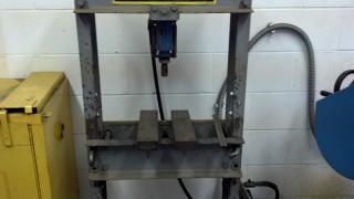

Personally I'm wanting to use up the old paper and grains from brewing giving me a ready fuel for camping or emergency. You can also mix in cotton balls shredded and magnesium to help the ignition like a big fire starter. My setup is for using a hydraulic press or bottle jack and car frame. I'll post pictures and more once I test the rig. Also you can use these in rocket stoves but it depends on the size of the rocket stove / mass heater.

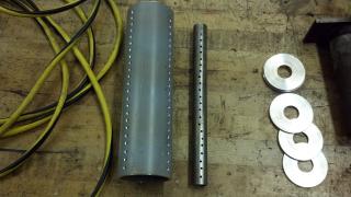

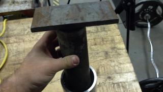

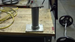

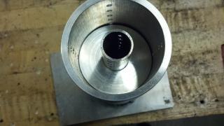

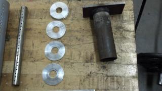

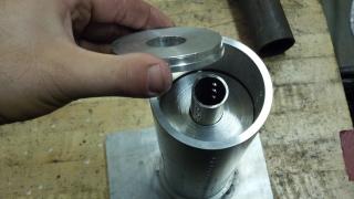

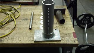

Pictures !
Parts
Assembly
Press
The outer tube & inner tube are drilled for venting water, the aluminum disks are spacers for multiple briquettes with a thick disk for pressing, the compression tube is sch40 steel with a 3/8" plate. Everything is loosely machined for easy removal after pressing.

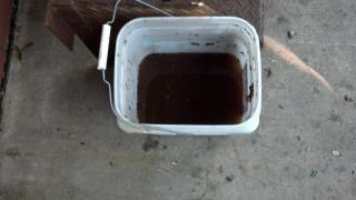

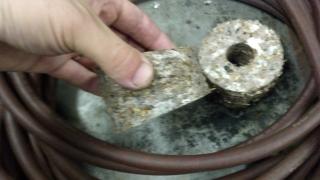

The mush
The pressed briquettes
Now to let them dry.
