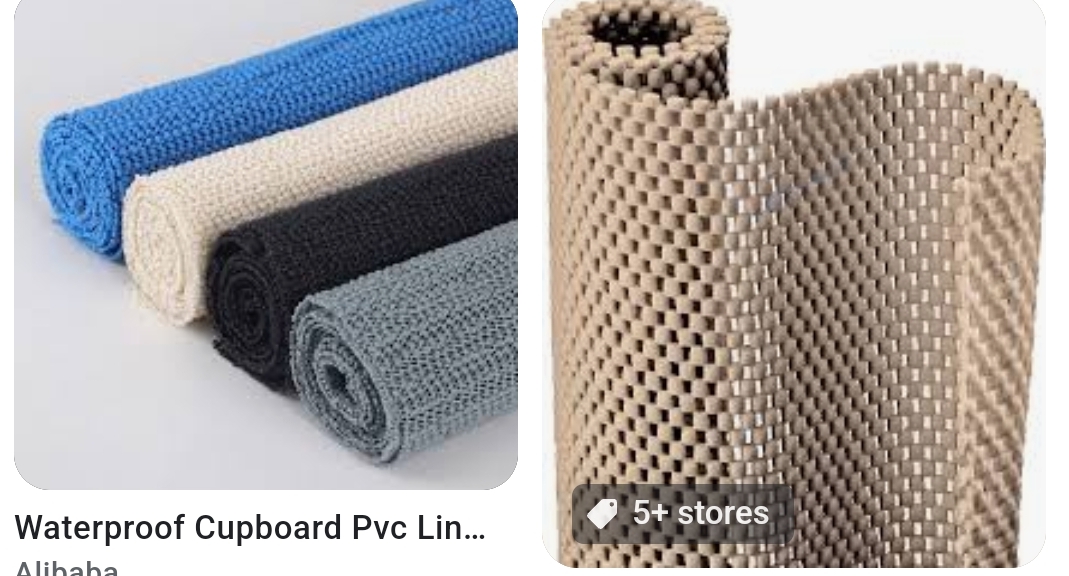

I put those cushioned and grippy shelf liners under glassware. It helps to stabilize them during small quakes.
Picture from google
It would probably be good under cans too.
