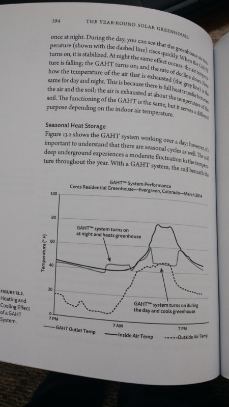

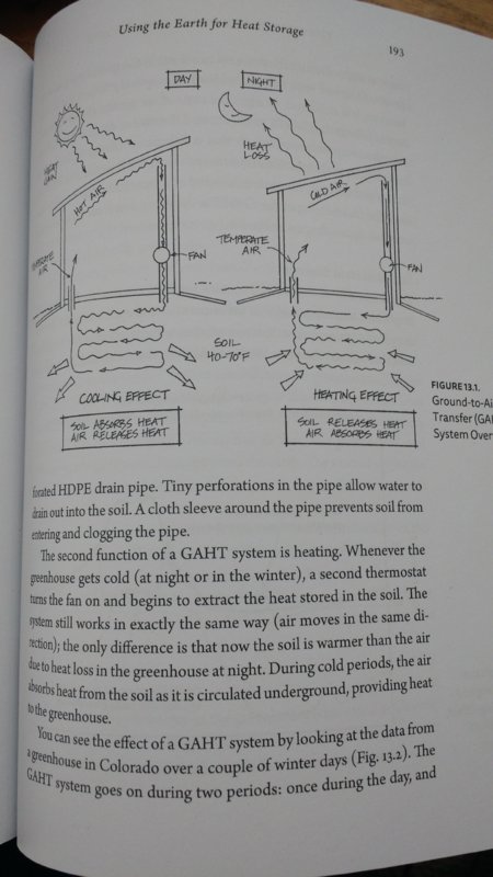

Very interesting (Ground Air Heat Transfer) for a greenhouse. Assuming you can excavate and backfill 5' depth (backhoe/skidsteer) the pipe and fan is fairly inexpensive. It's kind of like a very simplistic non-technical geo thermal heat/cooling pump.

There are various methods of doing this. The one I've seen most often involves a deep trench outside the green house. The plan is for it to draw cool air from below frost level up into the green house, where natural convection then moves the hot air out through vents at the top.

Heat rises to putting on the ceiling doesn't do as much good as if it were lower. Maybe the inlet should be higher than the outlet, but irregardless it's easy and cheap to adjust the inlet / outlet heights. But the whole idea behind the GHAT system is to satablize the temperature in the greenhouse to an acceptable range. Mainly 45 to 75 degrees irregardless of the air temperature outside the greenhouse.
For example, let's say in Kansas City, the underground temperature at 5 feet is 55. In summer, the air temperature can reach 100, and in winter as low as 20, but underground temperature at 5 feet is still 55. It's not that hard to get that constant temperature out of the ground so you could heat in winter and cool in summer to an acceptable temperature range.

Here's an introduction to GHAT in a greenhouse senerio.
