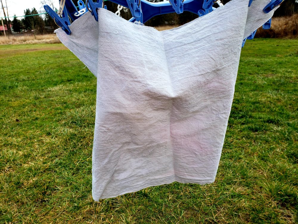

First ones went in a hibiscus dye. Really strong hibiscus tea and vinegar. Came out looking light pink/purple which turned more blue as it dried. Full light heather blue after 2 days. Even kept in the dark it turned light grey after a couple weeks. I didn't think it was so poor on the light fast. I know it's not very good on the wash fast.
This is after drying

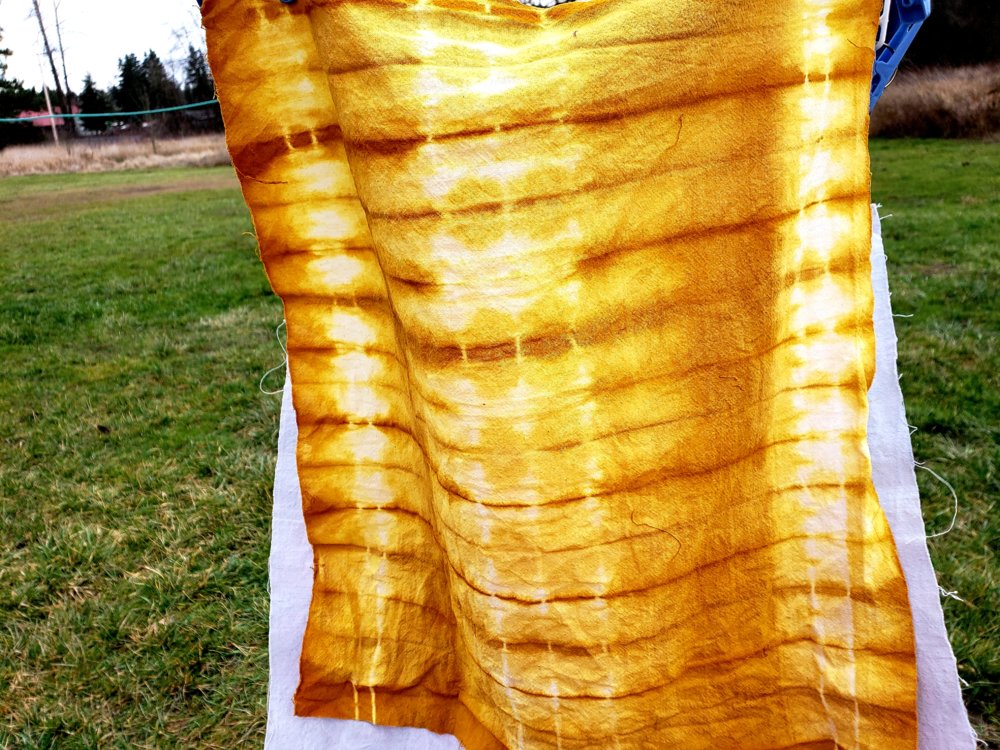

Second pot was turmeric with vinegar. Turmeric is wonderful to work with. I don't know if it even needs the vinegar. I do know it doesn't need a mordant. Pull it out when it hits the depth of color you want. Turmeric is wash fast but not light fast. It does last a very long time.
Again after dry

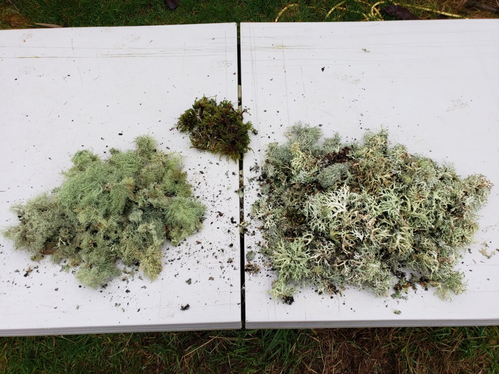

I collected moss and lichen from where it gets blown off my trees. Separated it by type. Lots of lichen since I know those work. I put some in half gallon jars with 2 cups ammonia and 4 cups water. I have to shake oxygen into them every day preferably to develope the color. 3 months of sitting and I'll strain for usable dye.
The lichen on the right is supposed to produce a bright purple or pink dye. We have literal tons of it so I'll collect more over time. It grows on everything. I'm going to dye some napkins with it I think. I have fabric resist so I may over dye a green as well, or just make a green ink dye to decorate. The colors should complement.

@Hinotori, thanks! I like how you explained each part with pictures. This is really interesting! That Tumeric fabric is a great color. Does it leach out onto other things if you throw it in the wash?

I only washed the dyes out. I can put a piece in some water and detergent and see if it leaches tomorrow. I'll try and see what my books say. It's a popular dye in India so I can look around and see what I find.

Are you rolling the fabric? I'm looking at the lines on the turmeric fabric. It looks rolled. We've dyed t-shirts before using Kool-ade. On those we grabbed a section and used rubber bands to hold it and then dunked each section in different dyes.

On the turmeric dyed fabric. More came out with the detergent. I went looking and it tends to fade for about the first three washes.
I think I'd wash it only with like colors for the first few.
