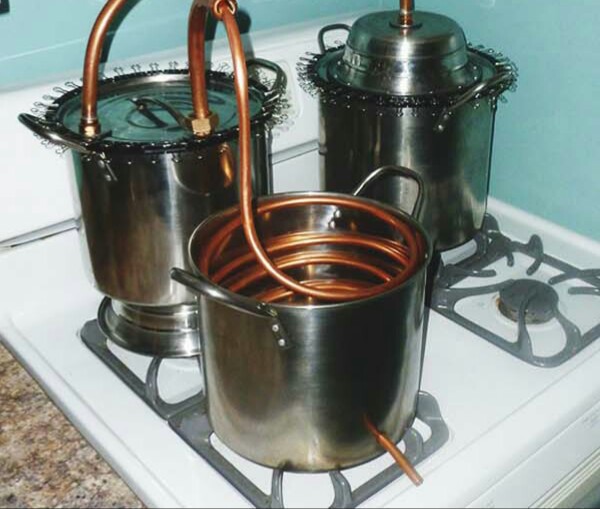

11,849
24,803
an old pressure cooker makes a dandy still-- just needs a tube that fits tightly over the release, than coil the tube through some cold water (or ice if you have it) and then into the capturing vessel. Works dandy to make alcohol, I imagine it would work for water desalinization too.
I don't advocate the use of such things, made of stainless and copper and I especially do not advocate the same with inclusion of a thumper.

My DH just explained what a thumper is (probably not needed for desaliniaztion though). That's a really cool setup there... what kind of proof would you get from that?
This is, of course (cough cough) for making truck fuel, right?
