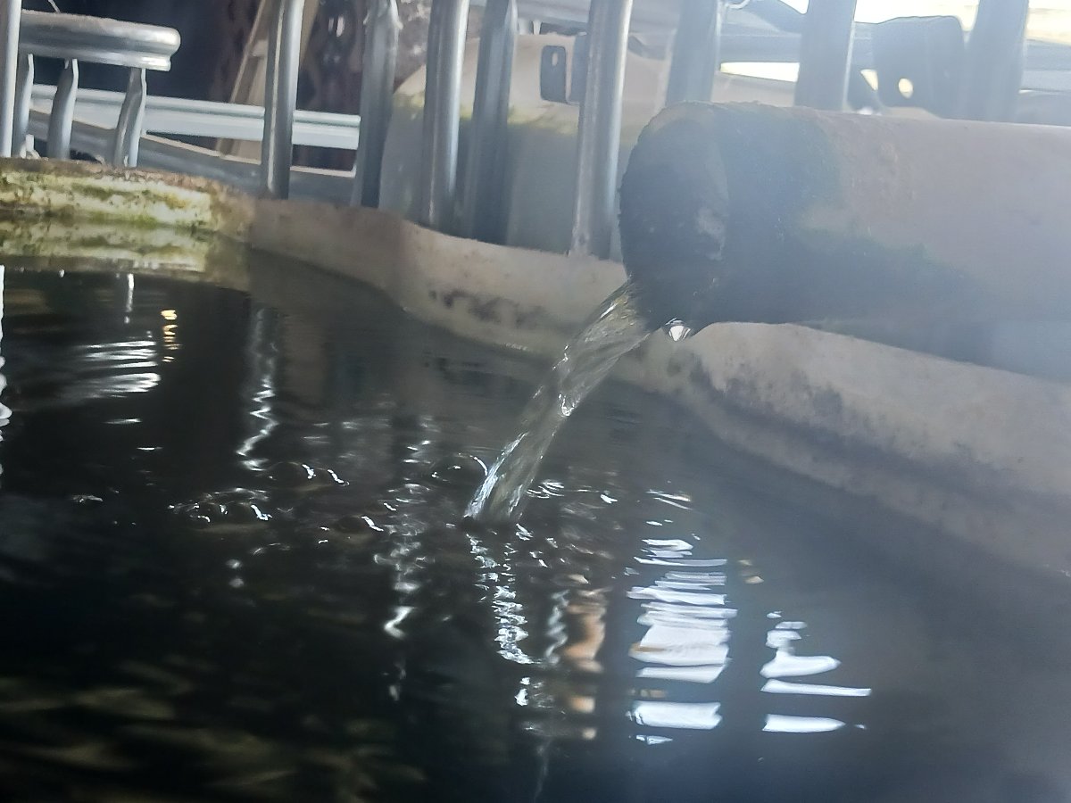

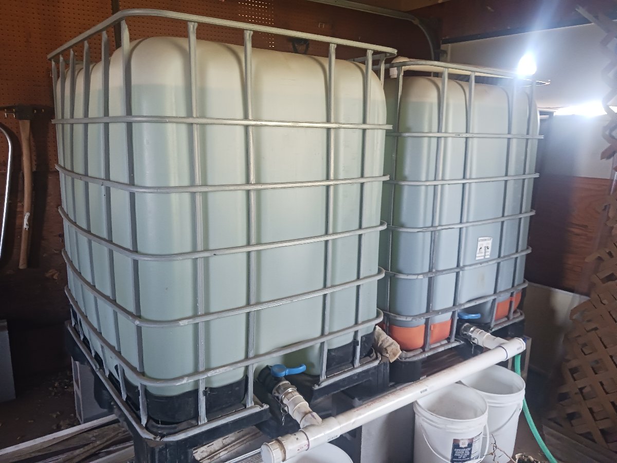

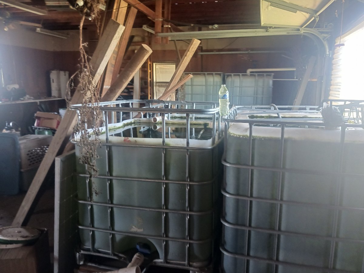

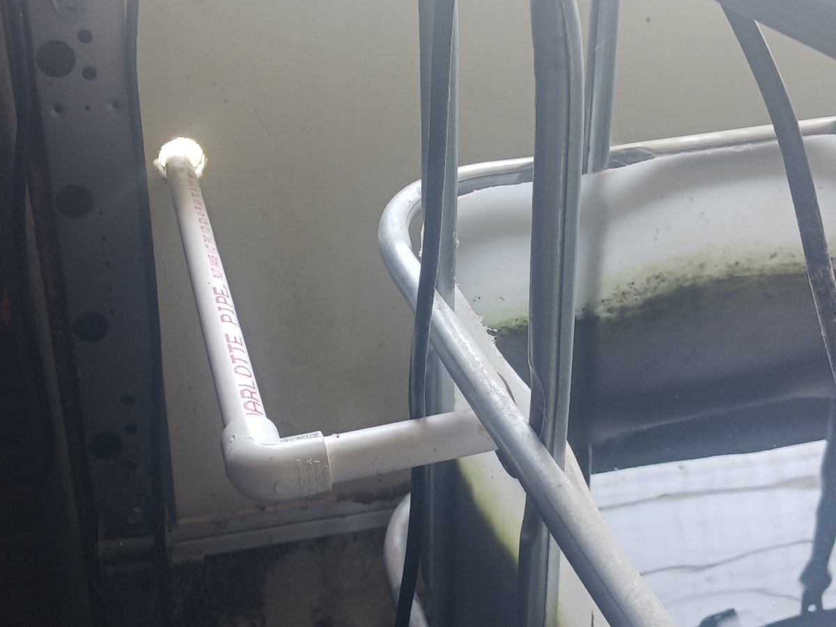

My system is 4 linked IBC totes in an enclosed garage. A pump takes water from the lowest tank to the highest, and from there everything is gravity feed. It is currently home to a couple hundred minnows and a few goldfish, which keep the algae under control. They spend most of their time at the bottom of the tanks, which tells me that the gravity "fountains" are aerating the water just fine.

I had intended this to be a garden as well, but at best it gets only 6 hours of light so I'm rather limited on what I can grow. Apparently there's not sufficient fish in the balanced ecosystem to truly support a plant population, and I'm afraid that increasing densities to the point that plants can thrive would kill the fish.

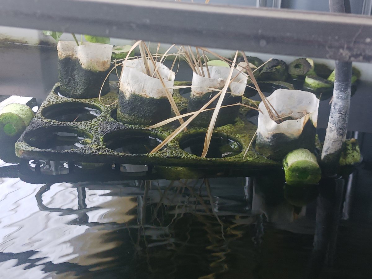

I'm working on it. Part of the problem is the rafts sinking under the weight of the plants and fully submerging the root zone. Another has been the rafts actually dumping over when the plant sizes get unbalanced. More fish food, I suppose, but irritating.
I have a repurposed solar panel that might be able to support more lights, but I hesitate to move away from the self-contained setup. I even winced at the necessity of the pump, but I got used to it. :)
