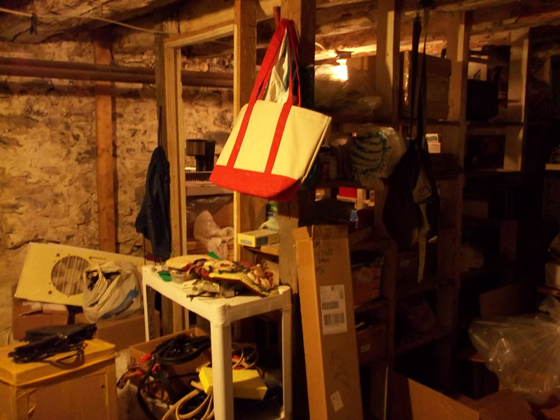

I went down to the cellar to take some pics and then realized the Pit (which has a wood cover over it) has a ton of things sitting on it, so when I get them moved, I'll take a few pics. It's just not in the schedule for today.
But the other side of the cellar I was able to get a couple of pics of....even though the area is loaded with stuff, too!
This area, counting the shelf space is about 6 or 7' x 8 or 9'. I would have to cover those pipes. They are heat pipes and insulate the ceiling. The area on the left where that stuff is piled up, is actually a "concrete shelf" that sticks out about 2 feet. I am guessing they did that at some point to cover the ground rock. The house is built on a sloping underground stone shelf. As you can see, there is a "doorway" into "room". I can only guess that at one time this was a cold storage area, and someone removed the walls...or, someone was building a storage area and never finished. As I said, my biggest concern with be the cold air intake and warm vent pipes. No way I am getting through this wall. It would be easy to vent the pit in the opposite corner...there is a window just above and to the left. I could take out the glass and run the pipes there. But, the pit isn't as easy to access, especially as we get older.

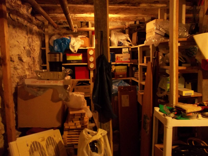

In this view you get a better angle at the shelves (even though they are partially hidden by all that stuff) that are opposite the northern most wall.
