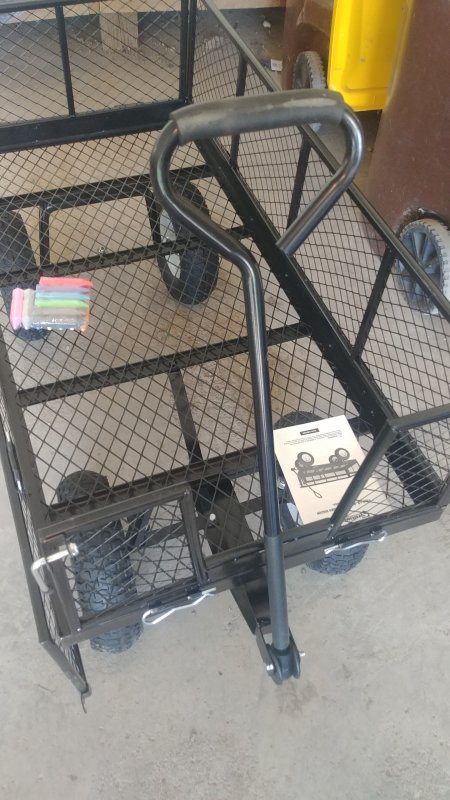

So my wife and kids got me a new garden cart for hauling stuff around. Yay!! However, I'm looking to modify the handle to be able to hook it up to my garden tractor, but I'm not sure what it is I'm looking for.
The cart comes with a normal pull handle, but I'm looking to tow it bwhind my garden tractor to easily pull stones, logs, railroad ties, etc...

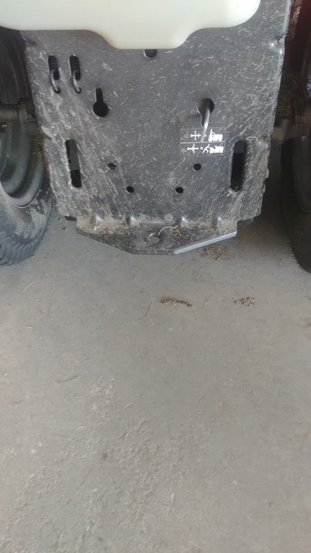

Here's the connection point on my tractor that it currently has

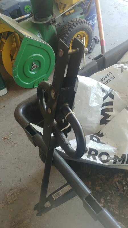

And Here's the handle I have on another cart that can swivel and connect to that hole.
So what's this handle called or have you modified something similar and can tell me a simple answer to my problem?
The obvious simple answer is to switch out the handles, but I'd like something more permanent

I googled "convert garden cart handle to pin hitch" and an Amazon AD came up for
"Gorilla Carts Replacement 2-in-1 Utility Cart Handle" which is very similar to what you show in the last picture. The cart would still have the handle, yet Switch-O Change-O - you can hook it to your garden tractor.
here is the link: https://www.amazon.com/Gorilla-Carts-GOR-HDL-D-Replacement-Utility/dp/B001H9NV9A

Thanks. I'll check that out. Figured I'd ask here to see if anyone's done this or something similar
