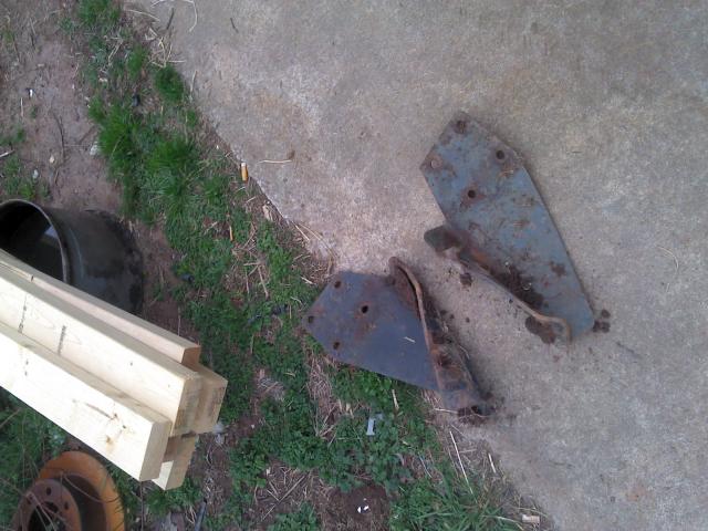

Hmm, well, I think I have part of the issue figured out!
Walked outside and whats been sitting in the driveway for 6 months?
These!
After DH's truck was totaled, the frame was bent right where the reciever hitch bolts up. These are the wings that attatch from the straight bars to the frame. They've been right under my nose the whole time :lol: Gotta dig through the pile of all them metal pieces and such and see what else I can come up with.
But they'll work for teeth :D
I wonder if I could bolt em to the old tailgate :idunno Hmmmm.....
