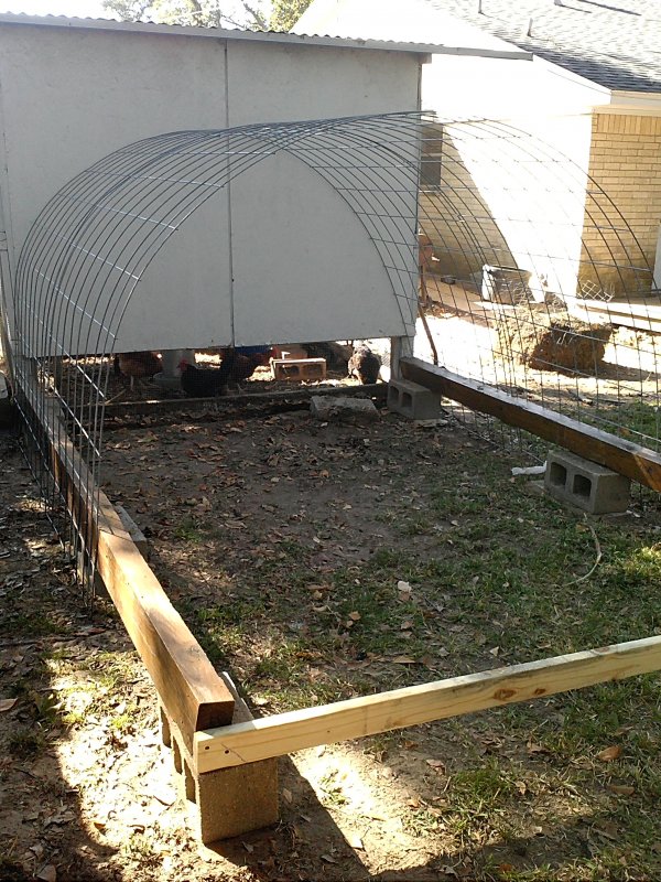

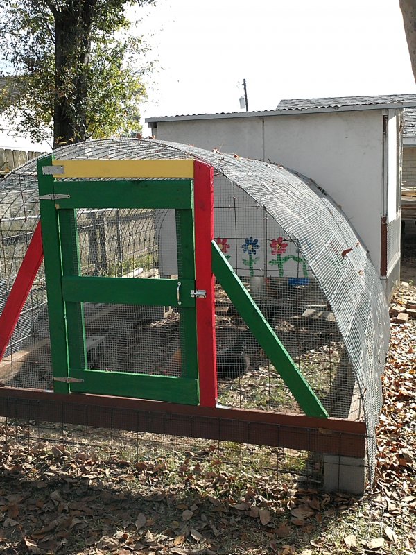

My coop is dirt floored as is my run. I pile in leaves, grass clippings, corn shucks and cobs, pea hulls, all types of vegetable matter. What they don't eat, they poop all over and scratch to bits. They are my garden compost makers! My run is made from cow panels, covered in hardware cloth, bowed over in a "hoop" stapled to a frame. I love it, was easy to build.

I put the frame on blocks because it was beams and 2x4's I had "found" and they are not treated. I had the blocks, so I raised the frame to keep it from rotting. I skirted the whole thing with 1"x2"x2' welded wire, laid flat on the ground to keep digging predators out. Study on BYC, there is all you ever wanted to know about chickens and a whole lot you never thought to ask. Be sure to come back and let us know how you are doing!
