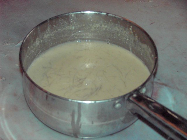

I put all three brains in a saucepan, added four and a half cups water, mushed it all up really really well and brought it to a boil.
Here is the brain - water mixture :sick
for anyone trying this...prepare yourself, I found it to be a very smelly saucepan. It isnt SMACK in your face smelly, just insistant.

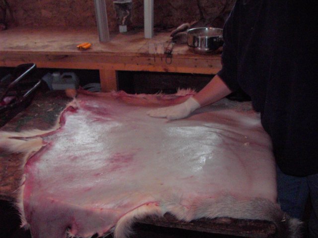

Here I am rubbing the mix into the hide. Yes I know it is supposed to be good for softness of the hands, but after I smelled it, I just couldnt.
Here my hide is all rubbed with the brain mixture and laying on a board to dry till tomorrow

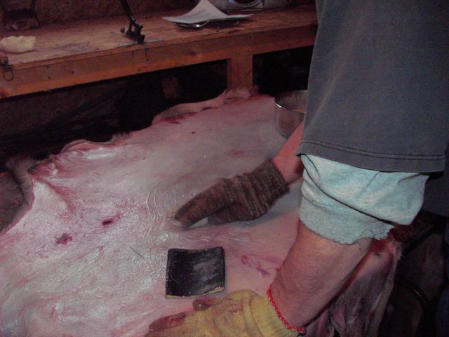

Here is hubby rubbing the mix into his hide (notice the washclothe? Not sure why he used that lol.
Here is his hide draped over a poleawating tomorrow and the second application.
The directions were not real clear on whether to tack it to a board as it dryed so we didnt. It also didnt say how long to rub it in for and I rubbed it in as good as I could. I even helped hubby rub his in.
