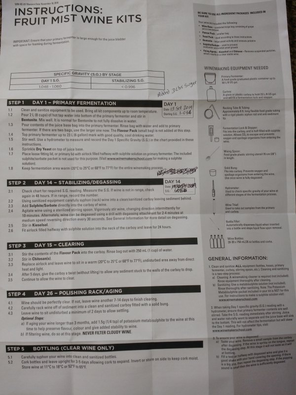

I started pineapple/pear late last night. The kit contains everything you need to make wine, except bottles and corks. I followed the directions with the exception that my buddy told me that a 5 gallon comes out better than 6 gallons.
I pulled a gravity reading of 1.060 after assembling the bononite (clarifier) warm spring water, the very heavy larger bladder bag and topping off to 5 gallons with cool spring water.
The kit says the wine should finish to a gravity of .996 or below. After checking the ABV of the original gravity, 1.060 and final gravity of .996, the wine would only be 9.9% ABV. Everything I've read says a bare minimum of 10% ABV is required for long term storage. But 12% AVB or above is recommended. So I stirred in 3 lbs of white table sugar. That put the gravity at 1.086 and hopefully at 12.0% ABV when it finishes @ .996.
I find it really strange the kit would come in with such a low amount of fermentables and also even stranger that they want you to add benonite at the very beginning. But hey I'm no winexpert, I'm here to learn.
The yeast that came with the kit is Lalvin EC-1118. I read up on it and it's a all purpose champagne yeast, theres nothing special about it. This is my first time using Lalvin wine yeast. So far my observation is It's a very slow starter compared to Redstar premier blac (champagne) yeast.
Pic of the instructions with my notes. I'll post again in two weeks, the next step per the instructions.

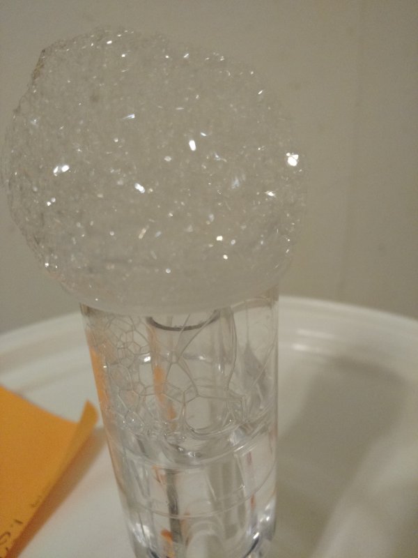

In order to get fermentation rolling, I had to stirr in 2 1/2 teaspoons of yeast nutrient (not included in the kit).
I think I'm producing alcohol now or a whole lot of gas.

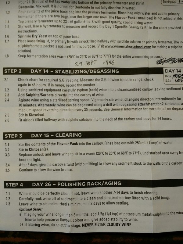

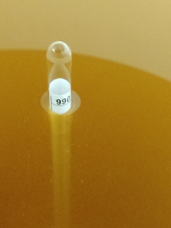

Well I'll be a monkey's uncle. I popped the lid and dropped in my sterilized hydrometer. Sure enough, a tad less than .996. So a starting gravity 1.086, ending gravity .996 = 12.2% ABV, now i'm happy.
Here is what it looks like after completing all if step 2. There was no more gas in the wine than any other I've made.
Tomorrow (day 15) I start step 3. I'll need to syphon off a little so the "flavor pack" will fit, I'll save what's left over for topping off and I'll store leftover in a sterile mason jar in the refrigerator.
So far so good, no major hickups. With the fermenting completed. its just giving it time to clear now before bottling. I guess I need to design a label now.

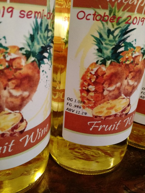

Bottled :) 26 days since pitching the yeast, not bad at all and it even tastes good. It will get better with age like all wines do. Yielded 25 750ml bottles or a little over 5 gallons.
24 750ml bottles, I gave one to my favorite daughter in law already.

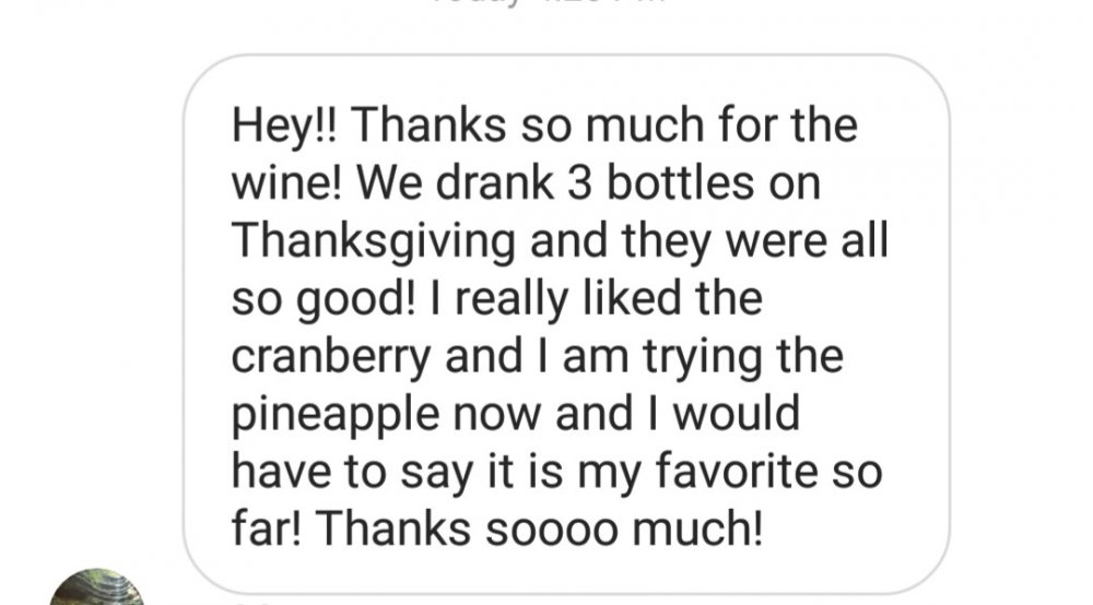

This wine kit has turned out to be a big hit with the ladies. That being said I really should rate this kit 4 out of 5 stars. Latest comments from one of my daughter in laws younger sister. The wine is a little to light and fruity for me but hey as long as the ladies like it I'm cool with that.
Latest comments
She asked me if I would teach her how to make wine. Sure I would actually enjoy that! I got my first student after graduating wine making academy :) I think we'll start with a cherry wine.since I haven't made that one yet.
