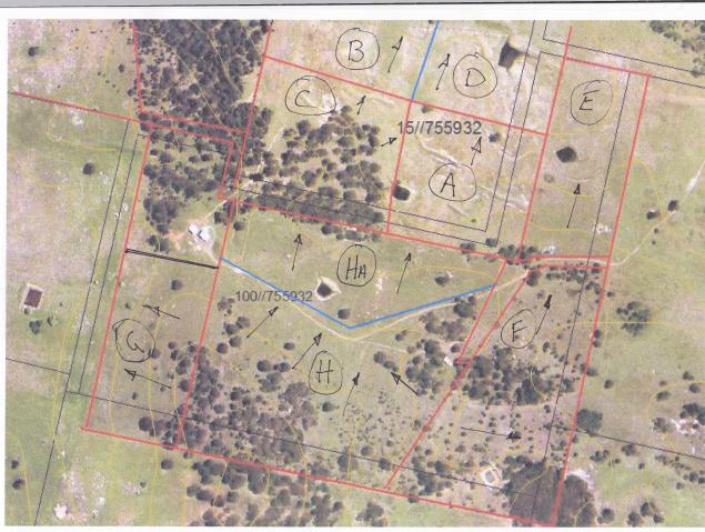

THE CHAT:..Grazing Management.........Well I did the job on the photo
Briefly this is what you have,the red lines are fences,the blue lines are proposed new fences.The area is 120acs,the arrows are the direction of the slopes.the basis of the concept is to never graze the a joining paddock on the down slope "SAY,D following A".
So starting with Ha then G,C,D,E,F,A,B and H.(does that make sense?)We try to work on 7day stay (depending on the conditions at the time)in each paddock,with sufficient stock to "mow ' down the pasture evenly,but without damage to the total ground-cover.
The above is a 9 paddock rotation(63 days),but we have more than this so the rest between grazing's is longer.we plan all new fencing on land-form and try to separate flat from rising ground

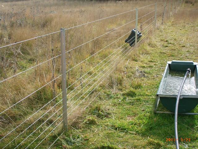

This is the fence we use for all new fences,with the addition of one electric off-set, I think it would be suitable for goats as well.Because of wildlife impacts(kangaroo's)we run the wires through the "star posts"so any impact is taken by the "end assembly's",not the adjacent steel post and we use a running tension of about 180kgs per meter.

Just saw your post with your rotation pic. Thanks for posting it.
