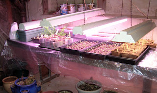

Here's the set up I have. My limiting factor has been temperature, since the set up is in our unheated basement, hanging out around 50 degrees.
I have 2 4' long fluorescent bulbs in each light, adjustable chains. They hang a couple inches from the top of the plants. Everything is staying a live; the salad greens and peas are doing well.
If you want to do a shelf set up, I'd recommend calculating the highest growth you expect from the plants, and then adding 6 inches onto that for the light fixture. Use that number to decided how far apart the shelves should be.
With florescent lights, they are going to need to be close to the plants.

Free, I haven't got a photo yet, but will try to do so this week. My lights are suspended about a foot above the trays. The whole unit is about 5'10'' tall, 3 shelves of 1.5 ft. (allowed 6 in. for the lights) which makes my lights about a 10-12 in. above the trays. My shelves are about 1 ft. and 5 ft. long.
I can fit five trays sideways on each shelf, with some 6 in. leeway on the ends. My trays overhang the shelves by about 3 in. on either side. I have a large reflector panel made of cardboard and tinfoil hanging on the outside edge and a light-colored wall on the other side. I built it right next to my chimney where it will get a warm, radiant heat if its cold weather and just be about 70 any other time.
I was being very frugal with materials, so my shelves don't have bottoms, the whole things is just framework and I put stiff cardboard under the trays to keep the moisture from dripping down onto the lights suspended below each shelf except the bottom one.
It will be more clear when I get a pic. I expect the light clearance will allow my taller plants to reach 10-12 in. before having to be removed. Since this is about the right height for hardening up, I think this will work out fine. If I had had more money, I would have built the shelve a little wider, as the narrow construction caused me to anchor it to the wall for stability.

You can't really put the seedlings much beyond the edge of the shoplight, IME. If you are really desperate you can put them a *little* beyond, like a row of cellpaks whose one edge is right under the edge of the shoplight fixture and the other is thus maybe 4" beyond it... but even if you put a reflector out there (I use old ugly white lace curtains :)) those plants will still get somewhat stretchy and unhappy. Really, the effective area of a shoplight is not much more than its own footprint, you know?
