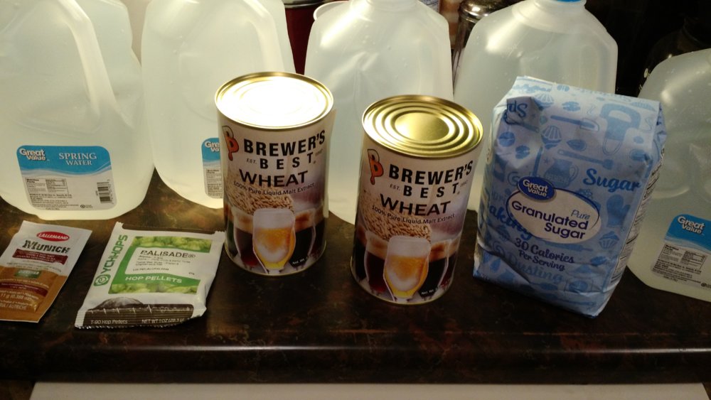

Ingredients:
2) 3.3 lbs wheat liquid extract
1 lb white table sugar
1 oz Palisade hoops
5 gallons spring water
2) packets brewing yeast (Ale)
Directions:
Bring 2 1/2 gallons spring water to a gentle boil. Stir in 1 lb white table sugar, 3.3 lbs wheat liquid extract & 1 oz Palisade hoops. Bring back to a gentle boil, and boil for 40 minutes. Turn off flame and add another 3.3 lbs wheat liquid extract. Add flame and bring back to a gentle boil. Boil for an additional 20 minutes.

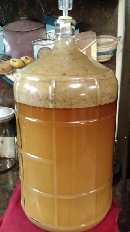

One active brew, had to install a blow off tube. The water in the bucket is gurgling.
Duct tape to the rescue... With all this CO2 don't show AOC, she might want to outlaw beer production :D

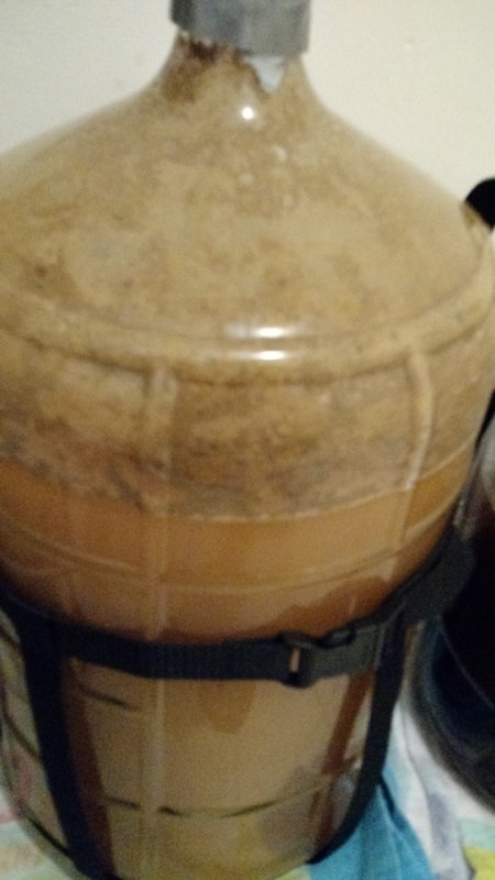

Plum Nutty... But I avoided beer on the ceiling, by installing the blow off tube and securing it all with duct tape. Duct tape is like one of the greatest inventions ever.
I'm just glad I caught it in time. I'm going to have so much fun cleaning the inside of this carboy, but its better than cleaning it off the ceiling any day :)

Day 1 - gurgling has been reduced to a fast burping. What a mess inside the carboy. I'm so glad that's where the mess stayed though. That's 5 gallons of beer in a 6 1/2 gallon carboy.

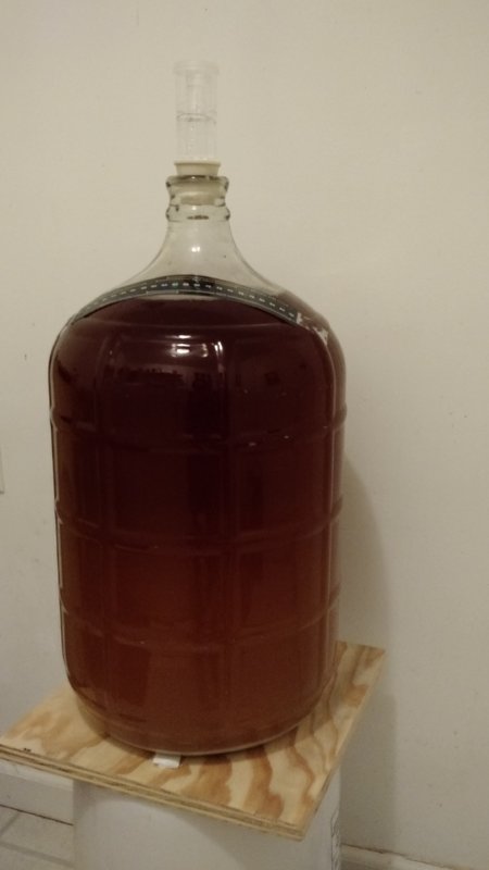

Day 5 - racked into a 5 gallon secondary to clear out. I calculated the alcohol content of 6.5%ish, it will increase to around 7%ish once bottled and fully carbonated.
This is what I call a yeast bed, glad to get it off the yeast.
Its actually quite delicious coming right out of the primary, lightly hopped and full of wheat flavor, just how I like a summer beer.
Letting my cleaner / sanitizer do its work on the krausen crusted carboy. The less I have to brush the better :)
10,752
20,281
377
Day 5 - really surprised how its clearing in such a short amount of time. I went to my fiends brew store today, to pick up a few things. I showed him this picture of it racked in the secondary and he talked me out of adding gelatin to speed the settling. It'll most likely be ready to bottle by next weekend. It looks a bit darker than it really is because the carboy is blue glass.
1 day in the secondary and its about 1/2 settled already.
