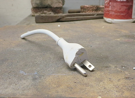

I cut a short piece of old 110/120volt power cord with a male plug end. I cut off the “hot” prong (in N.America the one that goes into the narrower slot of the receptacle or extension-cord female plug). The remaining prongs are neutral and ground. That way, there's no possibility of electricity going into the short remaining bit of cord. Hence the gadget is safe. The remaining two prongs ensure the plug can only be inserted with the proper, safe orientation.

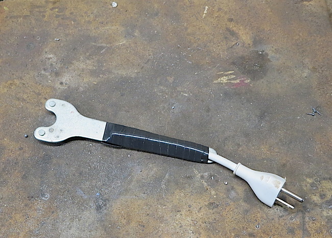

Then I super-tightly taped a grinder wrench to the piece of power cord. Getting it tight is important so that the wrench will never slip from the bit of cord.

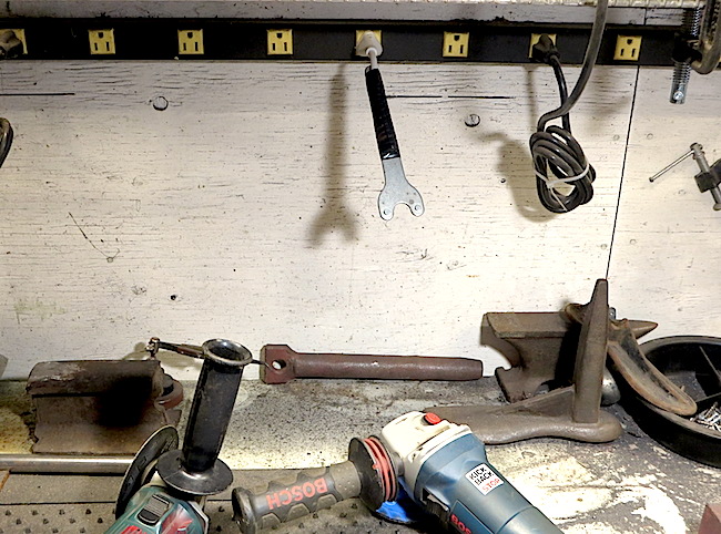

So whenever I’m using an angle grinder, I can have this wrench ‘plugged in’ to the outlet I’m taking power from. Also works nicely if I’ve plugged it into an extension cord where there are two or more female plug ends (one for power, one to hold the wrench).
