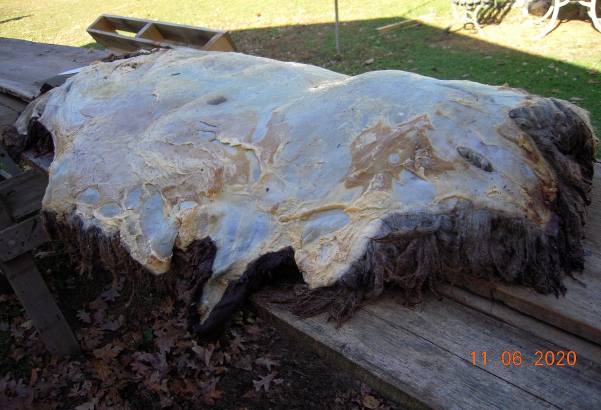

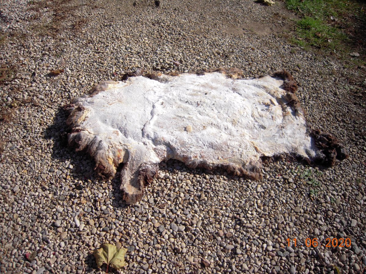

Here are some pictures and descriptions of some hides I've worked on. This was mostly done early November when we had temps near or at 70F.
Getting the hide out to work on. They've been stored for almost one year with salt on the flesh side. I scraped as much salt off as I could and put in a sack (the salt). It can be re-used. I rinsed the rest of the salt off, in an area away from plants and our well.

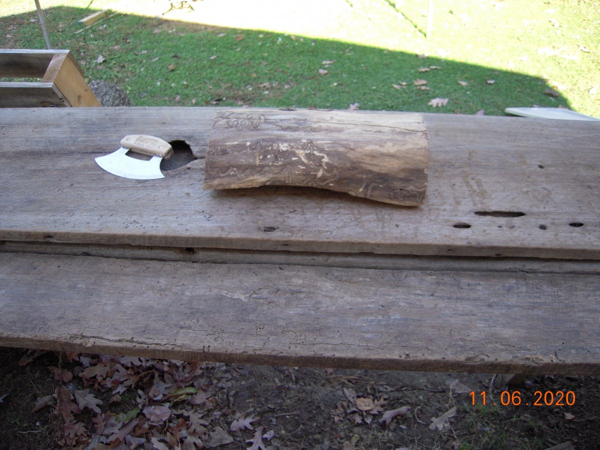

Here's my set up to start fleshing. Sawhorses on both sides:
Ready for fleshing:

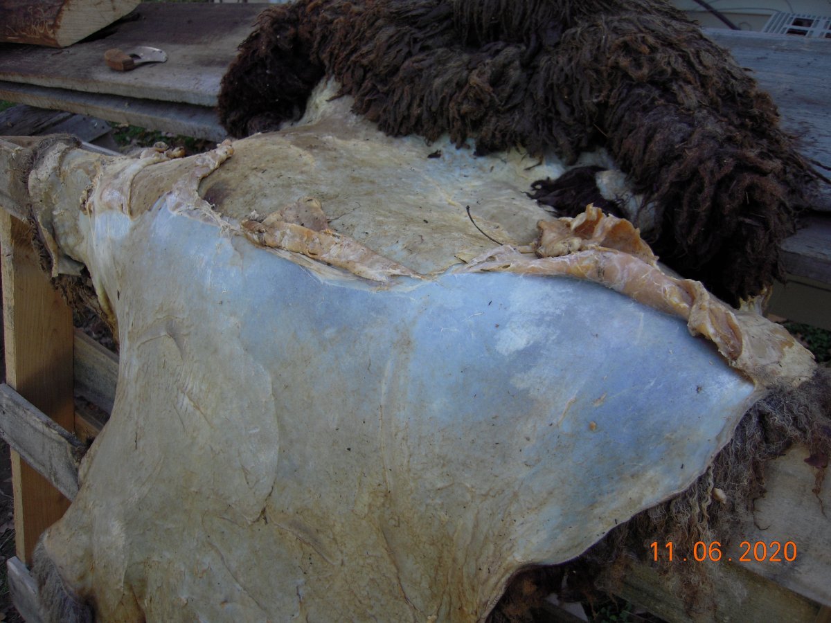

Here it is partially fleshed:

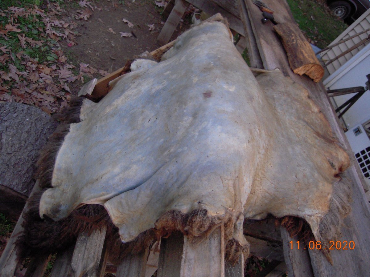

Fleshing is done. This is the third one so far. Have to make sure the membrane is removed with the fat and flesh. It's difficult to get every bit of membrane off. Without removing the membrane smoke cannot penetrate the skin.

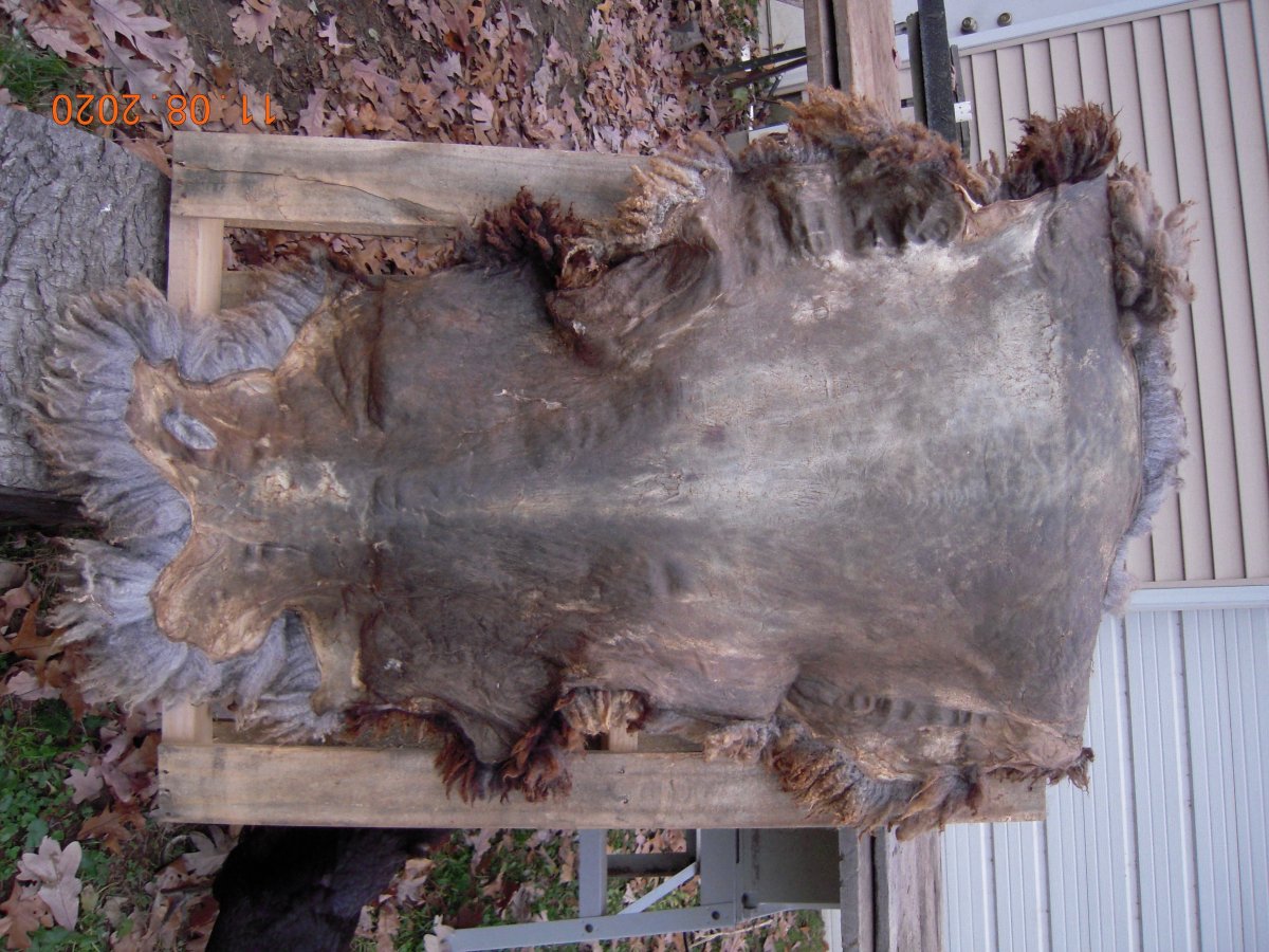

Here it is hanging and drying two days later. It should have been stretched out on a frame to dry.

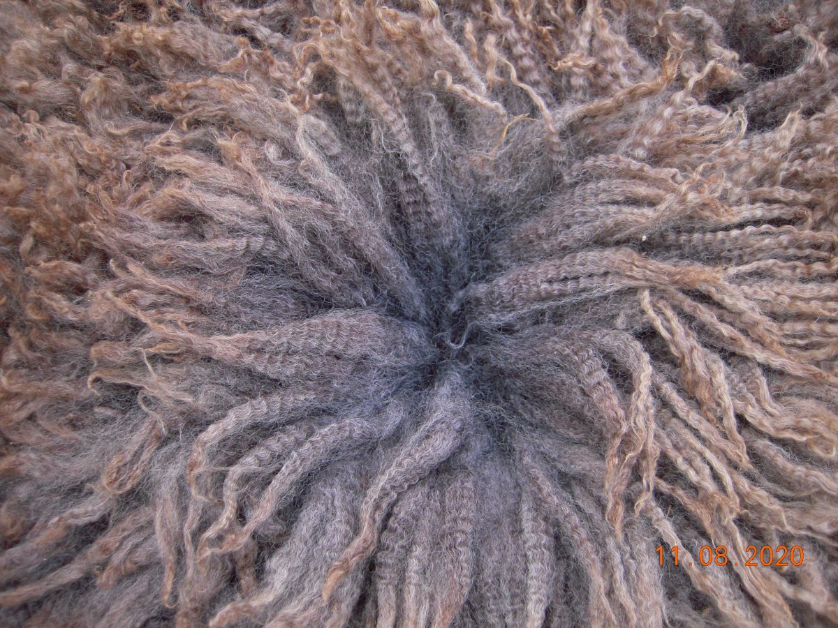

The wool side:

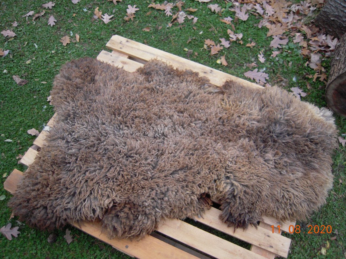

The wool is beautiful:

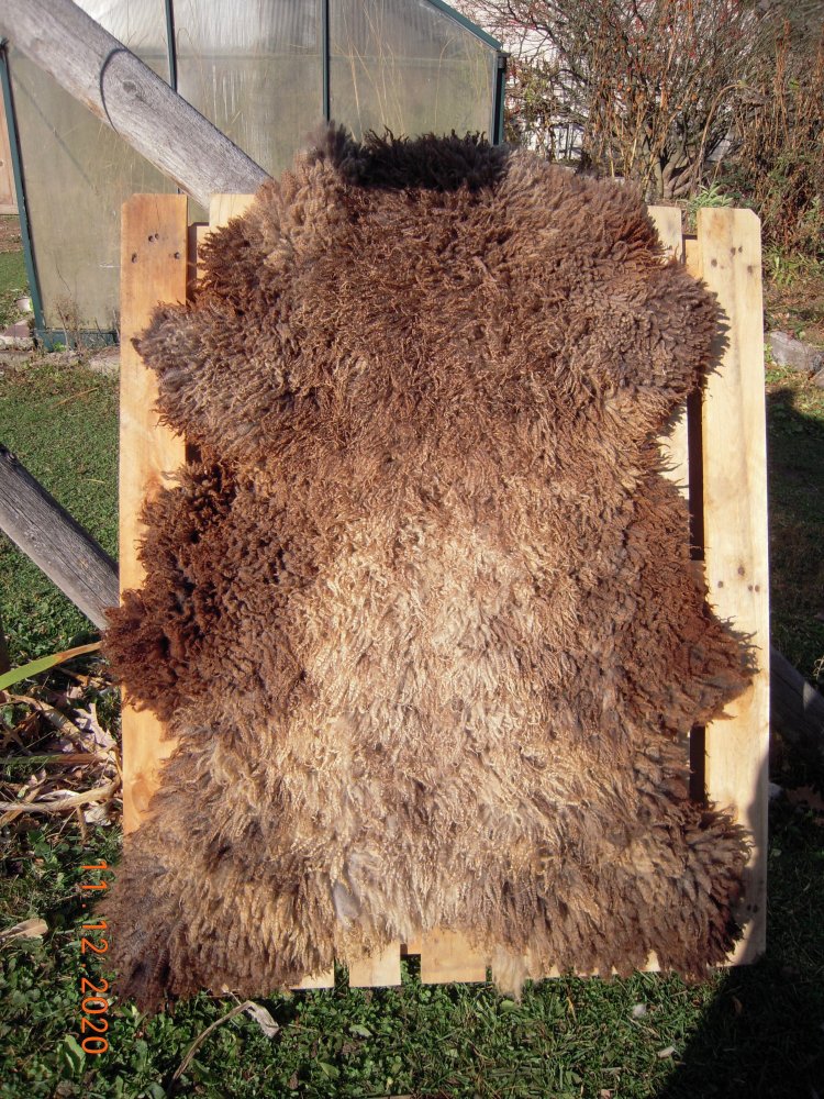

Here's another one that I fleshed since:

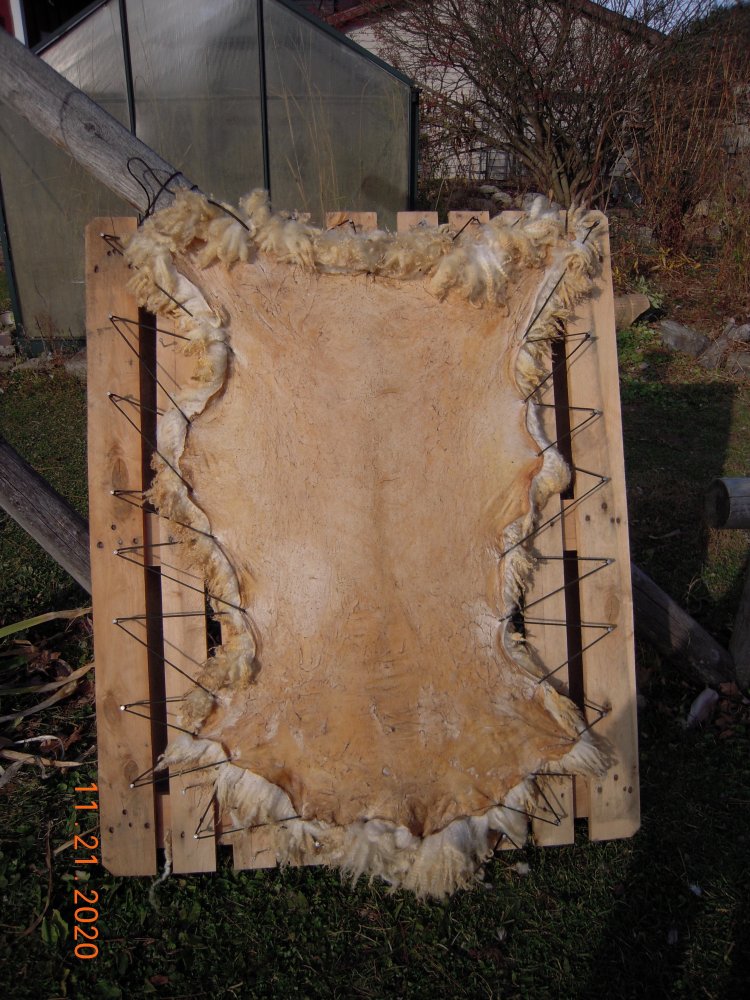

This is the last one of the five. After fleshing and washing about 500 times, I cut holes around the perimeter and strung it with paracord on a skid to stretch and dry. The stretching will keep the fibers from drying stiff. The lines on the skin side are parts of the membrane. It's okay that they're broken up, but still on there. The smoke should still penetrate all of the skin okay. I can't say for sure it's okay, since I have yet to smoke one.
