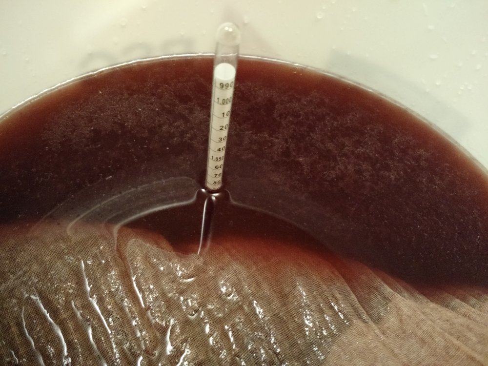

So I made up another batch of wine, Blackberry 1090.
The can of goodness, Vintner's Harvest 96 ounce Blackberry wine base
I followed the 3 gallon recipe on the back of the can. My buddy suggested the 3 gallon instead of the 5 gallon. He said the 3 gallon recipe will make a good tasting full bodied wine with Montrachet yeast. So I also bought 3 packs of yeast, to have a few extra.
Next I followed the recipe step by step and took a hydrometer reading, 1.090 on the nose :) so around 12% alcohol potential.
Now I just need to wait 24 hours for the campden to sterilize the must. Then I can pitch the yeast.

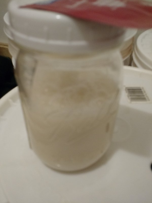

I just pitched the yeast starter in this blackberry must. I really need to get into the habit of making up a yeast starter and stop pitching dry yeast directly in wort or must. Its easy... sterilization is the key. 1/2 pint denatured water, teaspoon of table sugar, 1/8 teaspoon yeast nutrient and yeast. Mix well and after a few hours it starts foaming and looks a lot like cream.
Mix well again before pouring into the must, then mix the must well.
