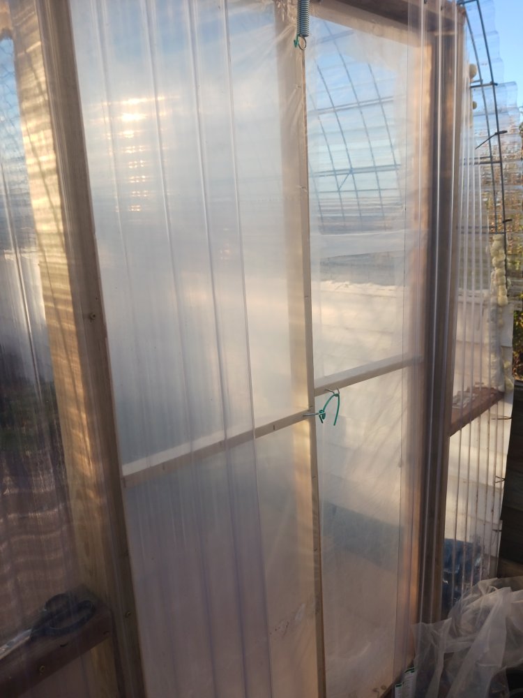

I did a temporary fix on the west end, but completed the east end and the doors. Even facing the house, the wind is still fierce enough to throw the doors open. I have temporary latches on until I can figure out a reasonable solution. In hindsight I should have hung the doors so they opened out, in spite of the space constraints (the east end faces the house and has about three feet between the greenhouse and the house wall).

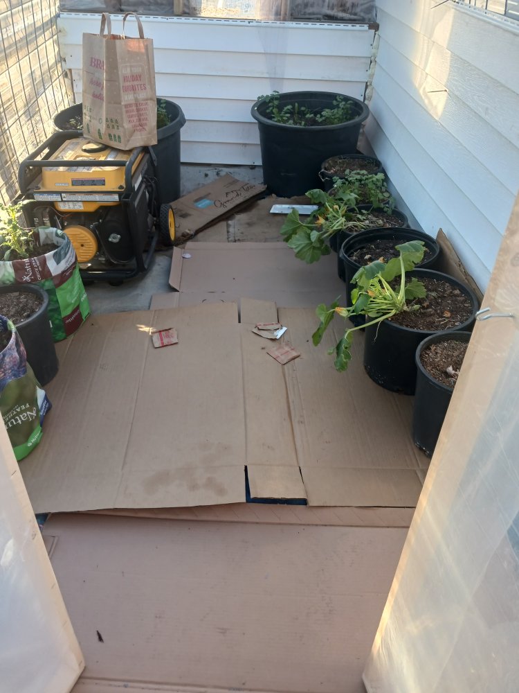

For the floor I used layers of an old trashed tarp, covered with cardboard. The base is sealed along the edges and I put in a few water bottles today for thermal mass.
Still not well sealed, but at least keeping the frost off the plants. More sealing to come after I fix a couple more structural problems.
Without being sealed, before any thermal mass and before the floor going down, it was running with the outside temperature but not as wet.

Did you insulate the floor?

In a sense. I put down many layers of an old tarp, and cardboard over the top. So the base is sealed, but not technically insulated. Bottom edges have been spray foamed.
There's one major gap on the house end that I need help to fix, and then I can spray foam the rest of the edges.
I put up sheets last night to temporarily block the largest gaps. This morning the temperature inside is 10 degrees higher than outside so I guess I have my culprit.
