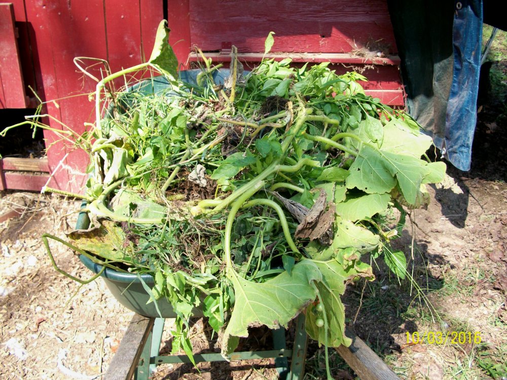

I also mix in whatever else I have available~wood chips, a little hay, a dab of straw(I also get this free just by forking up what falls off the straw truck at my local feed store), twigs, and all the green matter I take out of the garden at the end of the season, lawn clippings from my son's lawn in town, any and all kitchen scraps that the dogs and chickens don't consume, and anything else that will compost.

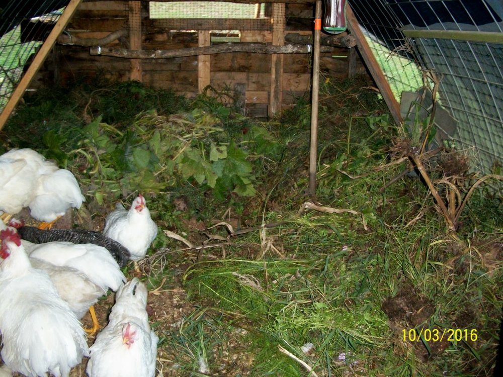

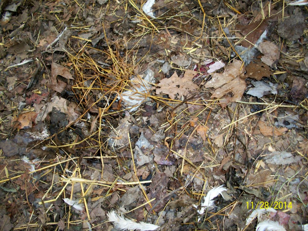

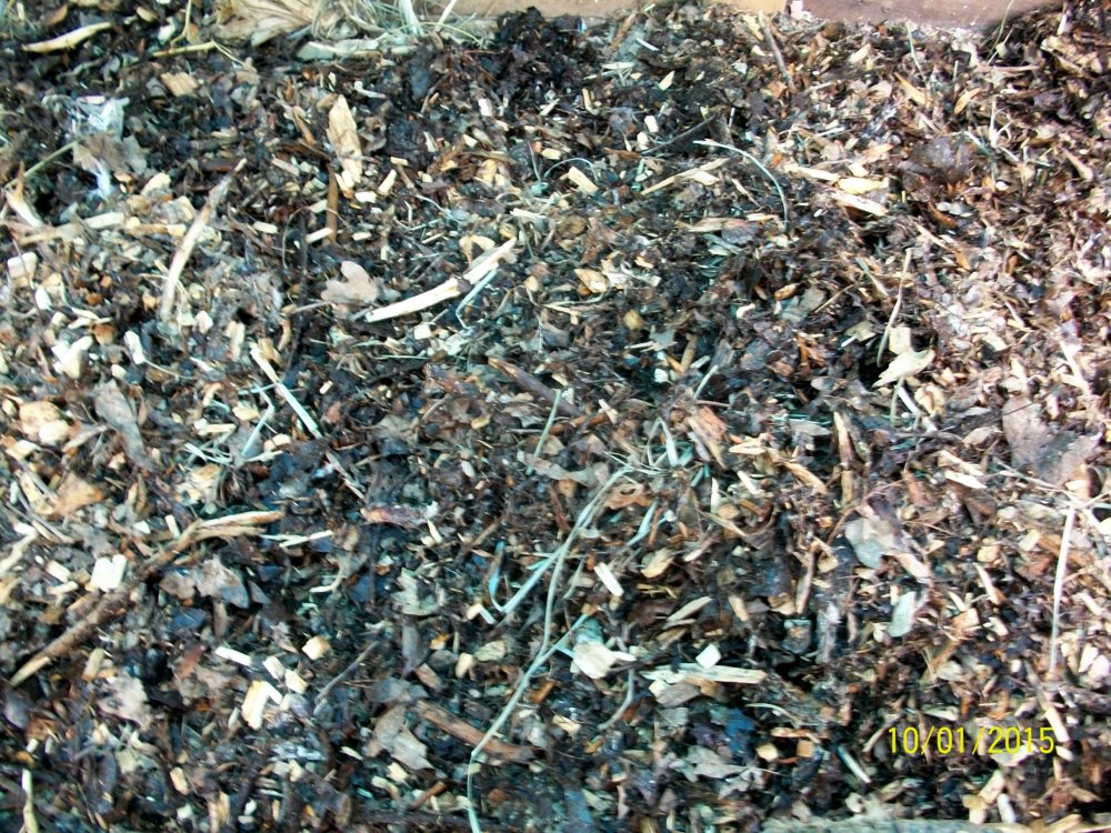

Pics of some of the things that go into this coop and come out compost...
A general mix of materials allows more air into the mass and speeds composting...if you use all one material, with all one particle size, it slows composting down.

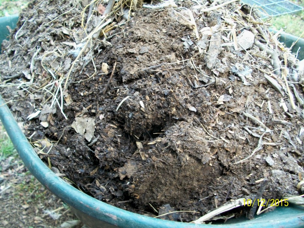

This is what it looks like when it comes back OUT of the coop...light as a feather, no smell except of earthiness like good compost smells.
It makes it kind of fun to dispose of things in there and then receive garden goodness come spring and summer. I can mix this with potting mixes, side dress directly with it without fear of burning up my plants, and can even use it like a mulch for moisture control around the base of the plants.
