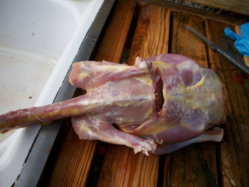

No, the head is off and the skin is slit from the breast bone clear to the neck, with the wings removed. Then, neck in the vise, facing away from me. I use my hands and some of my wt. to then pull the skin down off the body...with old layers, this has been invaluable. I have arthritis in my hands and it's become nigh impossible to shuck those older birds without the use of this vise. This makes for hands free working of that skin off the bird, while not having to hold it for leverage to pull the skin downwards, as the vise holds it for me.
The old way of gutting, the reaching in and pulling out, is sometimes hard on smaller carcasses if you don't have tiny hands and it often puts pressure on the colon, expressing feces out as one pulls. Some people tie that off prior to pulling the guts but we've never taken the time to do that, so this method of not having to pull on those guts is real handy. Makes for a cleaner removal of the innards, IMO.

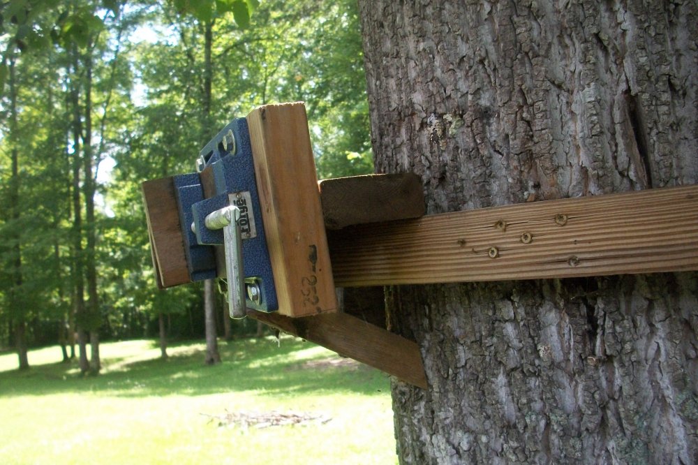

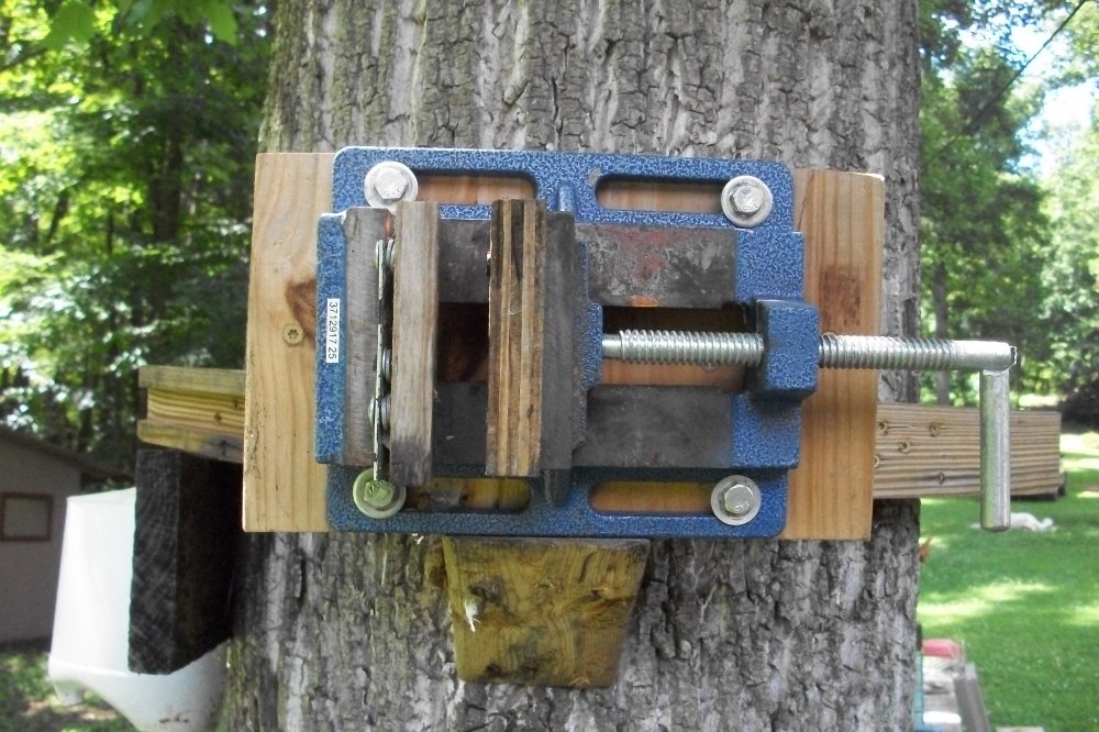

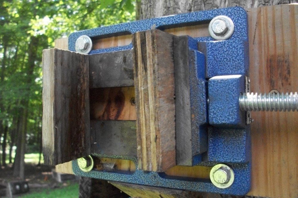

Bee, can you show a few close up views of your vise system and it's mount to the tree?

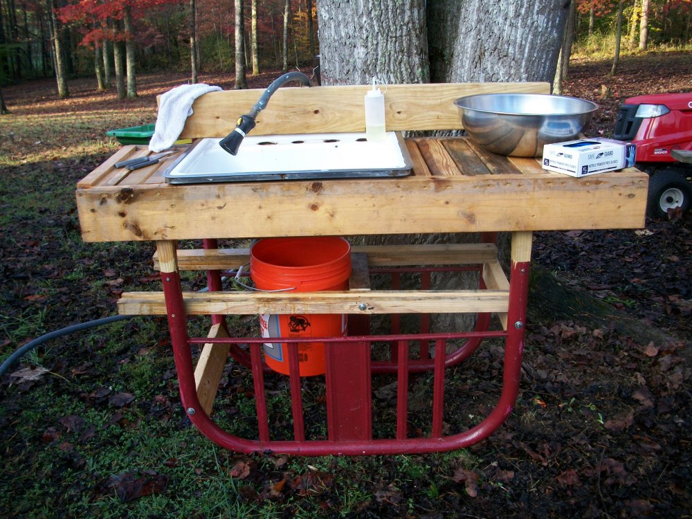

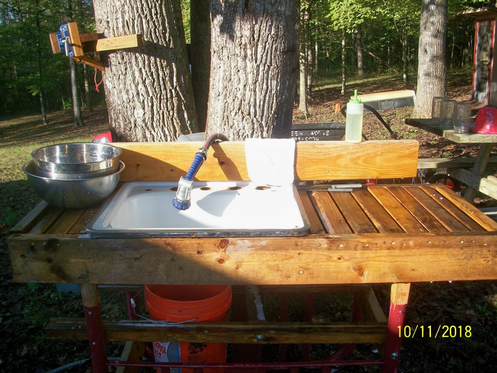

Had to go out and take a few....I'll throw in a few pics of my one woman processing station I made a few years ago out of an old sink, a vintage metal youth bedstead and some free Lowe's "stickers" and other scrap lumber obtained for free. Made it this way so I could move this table when needed, with the bed stead acting as a skid....in the early spring I move it to full sun and use this as my grow table....place metal tunnel hoops on top, cover with row fabric and put my seedlings out there.

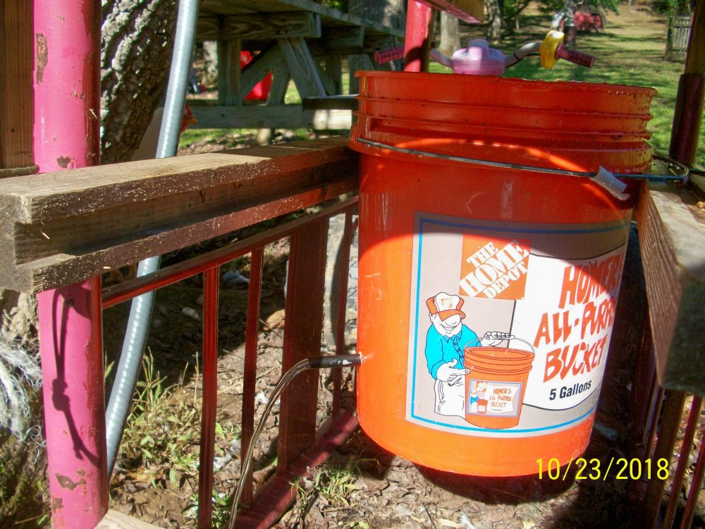

My gut bucket...collects all the offal and shoots the water out and away from my work area.
Got the drill press vise from Harbor Freight and had Eli, my middlin', retrofit it to hold a chicken neck better...the addition of small pieces of wood in the grip plates helps hold the neck better, but more gently, if that makes sense...doesn't damage the meat when I have to crunch it down tightly, nor does it let it slip out when I have to pull a stubborn hide with some force. Rubber pads would work just as well but I didn't have such a thing on hand...but scraps of wood, I have a plenty.
It's a good idea to pop it out from whatever you've got it mounted to, as the bird's breast will come in contact with the mounting surface. I found that out when using the first attempt, but had Eli bump it out from the tree a bit until nothing touches the carcass but at the neck.

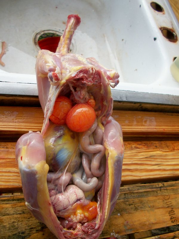

Another cool thing with this setup...when you get the hide shucked down and cut off the tail, you can then work around that rectum with the knife, very easily cutting the fascia anchoring the intestines in that area without fear of puncturing the bowel as gravity and positioning of the carcass(lifted up at an angle with the left hand while the right hand does the knife work) pulls the bowels away from that area.
And a few more pics of that gutting method~not my own method, BTW, but one I observed on a vid on YT...can't remember the vid right now and didn't save it but will be using it from now on~done on an old layer bird....
