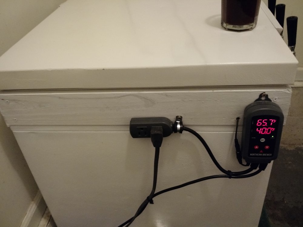

I've been using this dual temperature controller and the freezer to cold crash and lager just above freezing. Its a slick little controller. It came with one of the brew gear kits I bought from an individual off of Craigslist.
https://www.northernbrewer.com/products/northern-brewer-dual-stage-temp-controller

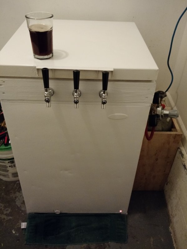

My little redneck ice cold beer on demand machine is complete.

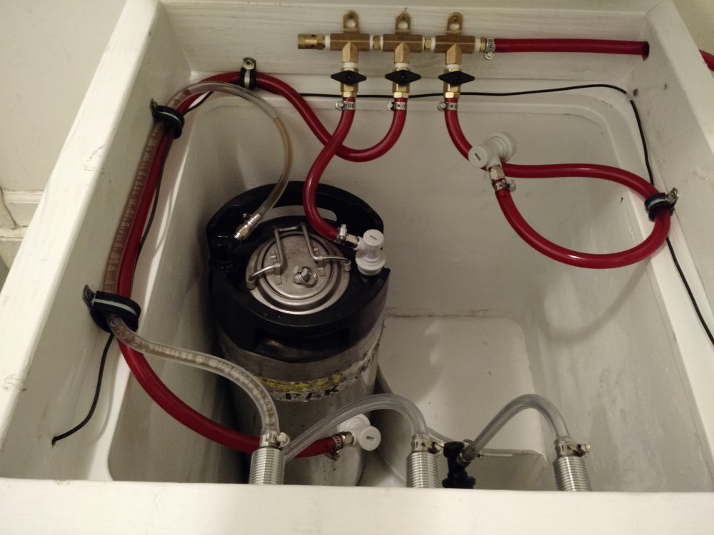

First pour :) the Oktoberfest is still warm but I had to try it. I built a simple 8 1/4" square box for the green house gas (CO2) 20 lb tank (right hand side).
I set the temperature controller for 40 degrees, its currently 65.7 inside the freezer.
Only the left faucet is loaded with a single keg of dark Oktoberfest. Even at room temperature the beer is malty and delicious.
I'm pretty happy with it.
