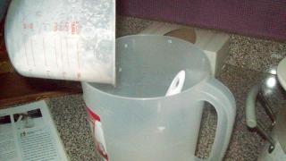

Then you measure you Potassium Hydroxide and water
Add you KOH to the water, these are in bigger flakes than sodium hydroxide so make sure they all dissolve. Make sure you go slowly and don't just dump it all in.

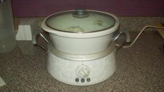

Check and make sure that it is fully mixed. If you notice any seperation at all. Keep mixing. Potassium based soap want to seperate much more than sodium based soaps. If it is fully mixed put you lid on the crock and start cooking it. I turned it from High while mixing to low with the lid on.
Stir every the mass every 20-30minutes over the next 3 hours. As it gets closer to being done, you will notice that the soap paste will start to get translucent in places. Keep going.
