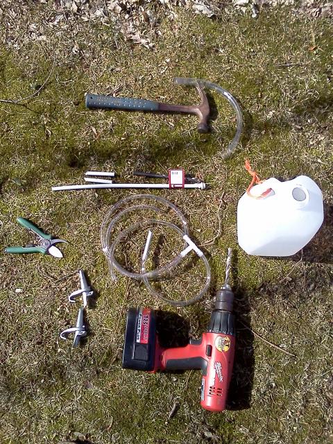

After about an hour of standing around the plumbing and electrical isles at Lowes, I finally picked up a few things to try out at my mom's house. Making this work on the cheap was my first priority. She had about 5 large trees, so I would need at least 10 taps, and there was another huge tree in town that my friends said I could bleed. Here is what I came up with....
click to enlarge
1] Hammer
2] Cordless Drill
3] 3/8" pvc water supply line for a toilet
4] 3/8" drill bit
5] Pruners (to cut the plastic pipe)
6] Nails (to hang jugs from)
7] Jug (I like them to be at least 1 gallon)
8] Clear Plastic Hose (to put on the end of the tree spout and direct the sap into the jug)
I also bought some smaller clear tubing and platic couplers, so that I could hook two spouts to drain into one big bucket. It works pretty well. Think of it like an I.V. drip from a tree!
The cost was under $10 for spouts, tubing and buckets (I already had the tools)

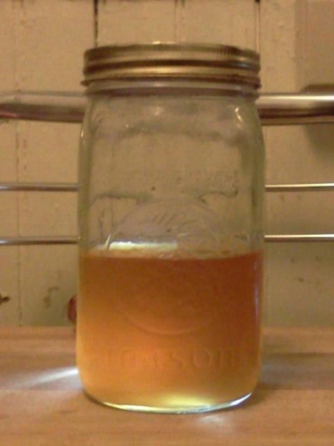

My first small batch from the one neighbor tree!
We are home most of the time right now. The stove runs constantly to zone heat...so we keep a couple pans on the stove going all the time. This first batch was done in stainless steel, and turned out a pretty light color. It has a very delicate flavor.

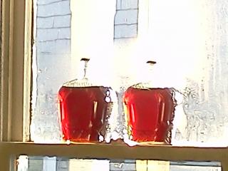

My Mother's trees turned out to be about as much as we can handle on the stovetop! She brings over nearly 20 gallons every three days!! To handle that, we have a 1 gallon iron pan and a 3 gallon aluminum pan on the stove. We even hauled out the rectangular turkey roaster pan for a minute...had that inside the oven with the door open. It worked. The walls and windows sweat with humidity... The upstairs hall has rolling fog!!! But the house smells like maple and is warm and toasty from the humidity.
It turns out that the iron pan changes the color of the sap dramatically. The flavor is effected also. I think it brings out the rich maple, carmelized sugar profile more. It amazes me that the little 1 gallon iron pan will cook twice as much sap as the other pans.

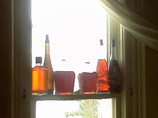

The hual to date:
two 750mL wine bottles
three 375mL wine bottles
three 750mL liquor bottles
Mom ran off with one of the 375mL bottles, and we've used most of one already. But that's not bad I don't think! That means we've finished a little more than a gallon of syrup to date. I hope we've got a few more weeks of this!!!
