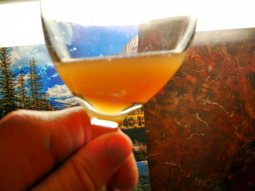

Just pulled my 5 gallon keg of May Bock out of lager and tapped it. I dumped the first pint of nasty trub beer from the bottom of the keg. But the second pint, although cloudy looked ok to try... it needs more carbonation but for a strong alcoholic beer, this stuff is the bees knees. It's smooth as silk, malty sweet and tastes like a honey biscuit. You know when you take a warm biscuit and cut it through the middle and smear honey onnit and eat it. Yeap that's it but this May Bock is the liquid version of that. It's even honey in color, with a off white head like a biscuit.
Bocks are by far my favorite beer style. It's on 30 PSI of CO2 at 35 degrees Fahrenheit. It should be ready to go to usher in May.
Probably a good thing I have to wait until Friday because I drank this pint to fast and I'm buzzing like a bee now. If I type any more I might start confessing sins or something... Yeah that's enough of that for now.
