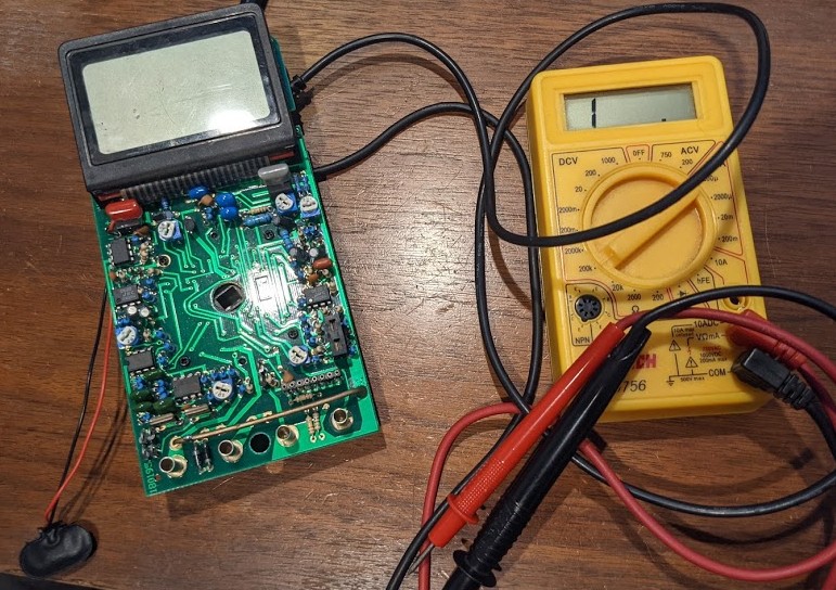

When you have to use your cheap multimeter to troubleshoot and fix your more expensive multimeter...

Ya, I have a bunch of the cheap ones too... but I like this one because it has a nice easy on/off switch, buzzer for continuity, rotating screen, 20A limit, etc., so it was worth it to try and give it a fix.

It was so frustrating! I would be testing circuits, etc. and it was zeroed out... but turns out there was a flaky contact on the positive terminal that when moved just a TINY bit in the wrong direction it would connect, disconnect, connect, disconnect. REALLY great when you're trying to see if a circuit is hot, meter shows volts on a test circuit, then you move the meter, it shows zero, but then you discover the meter is lying to you!
Some troubleshooting and then re-soldering the terminal did the trick!

Glad you got it fixed.
