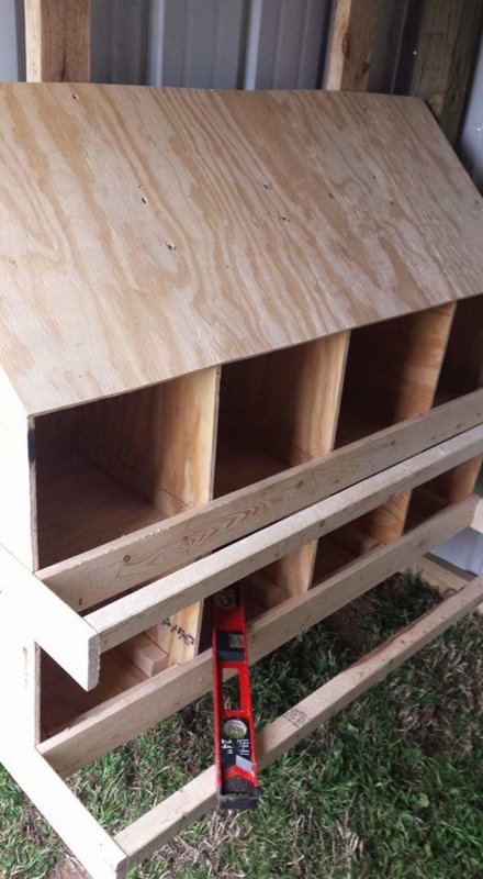

Here's mine. It's perfect as far as I'm concerned.
2,763
4,671
I don't remember. I just googled nest box plans. I think the boxes are 11 or 12 inches each
