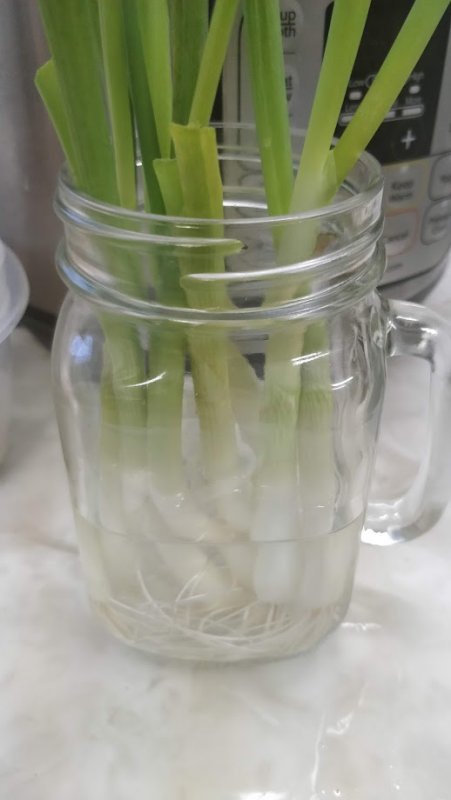

Ok, I know this is probably a slippery slope, but I thought I'd DABBLE in this a little bit. I guess technically I already am.... ;)
A few months ago I had some green onions from the store and ended up putting them in water. I was SHOCKED at how fast they grew!!! :ep
So, I got to thinking it might be fun to take this to a slightly higher level. Nothing crazy, but just a fun little project.
