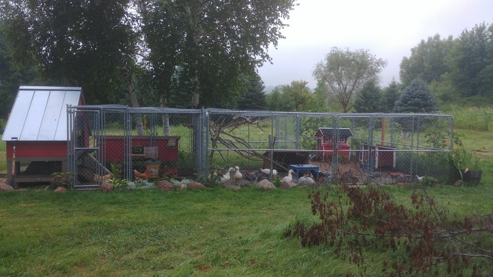

The layers are just over a year old, so there aren't any "old gals" quite yet. They are not free ranged this year. Last year we let them roam but chickens do as chickens do and the wrecked all my gardening and lanscaping. We're actually working right now on fencing in a very large area around their current coops and run to let them range again.
