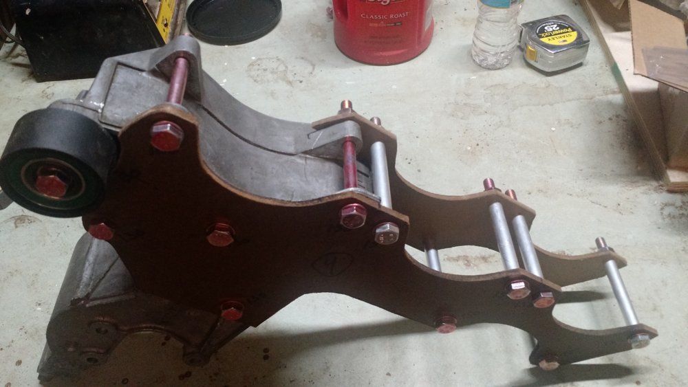

Will do... the third alternator should be here tomorrow. it's another AD244 250 AMP. That'll leave one more to order. Still working on wooden quad alternator templates to attach to the power steering bracket which is cast aluminum so lots to tweaking with files. I'm going to do the brackets in 1/4" 6061 plate aluminum. so I can use my router and a carbide bit to cut the aluminum and make copies of my wooden templates but out of aluminum instead.
Here's how far I've gotten with the quad alternator templates brackets out of wood. Three alternators across the top and one underneath. I'm just about happy with the templates.
Basicly my plan is to swap out the entire power steering backet and bolt in this power steering backet with the quad alternator bracket bolted to it. This is where the 4 alternators will sit under the hood. To the right of the one that's there now.

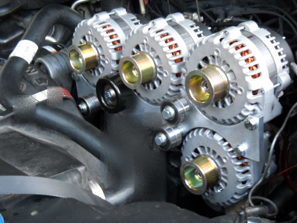

All I'm working off of is an internet picture, so hopefully it'll turn out as good. This is a single 3/8" thick bracket. Mine is going to be a sandwich of 2 1/4" backets. One in the front and one in the rear. I think a sandwich will be more strong than a single bracket like what is pictured.
