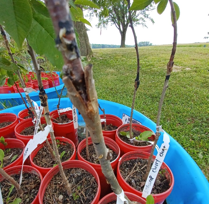

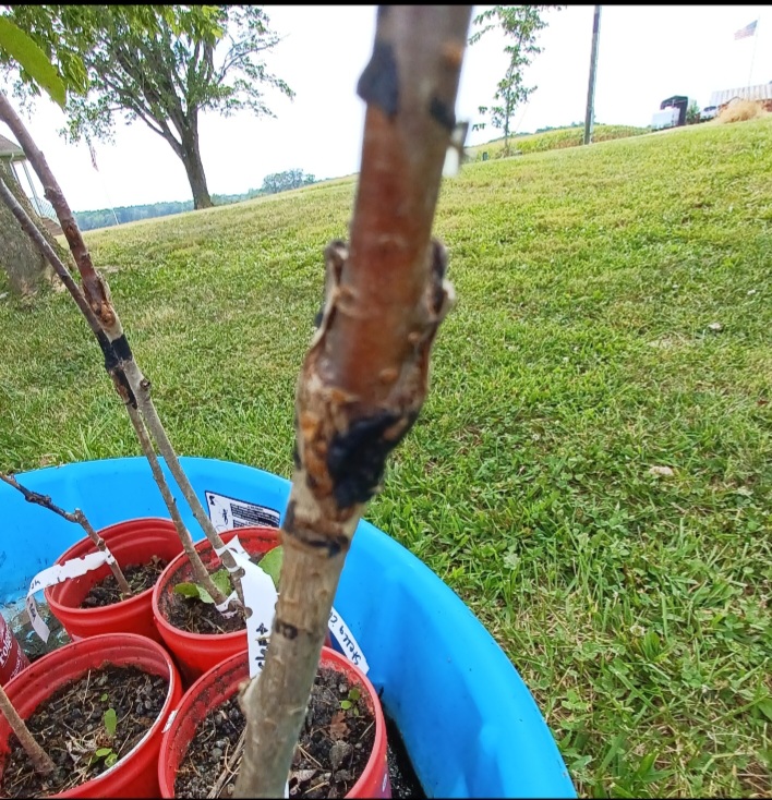

With the parafilm narturally decaying and falling off I cant help but notice that cherry cleft grafts can look ugly. When the root stock diameter is larger than the scion, in order to match the cambium you sometimes have to push the scion off to one side or another. This leaves one side open but the other side calluses. Eventually over the growing seasons the entire graft will calluse over and it wont look so awful. Just remember your going to get some cleft graft die back on the rootstock with cherry. So you want push the scion deep into cleft and line up the cambium deep and below what will die back.
The cambium aligned side good callusing deep in the cleft, not so ugly.
The non-aligned side. Still good callusing deep in the cleft, which is what you want with cherry. Hopefully you can see how much die back there is. Push or tap that scion in deep to allow for die back and either match or cross the cambium deep and it should take. Cherry is a hardwood and one of the more difficult species to graft, I believe for this reason.

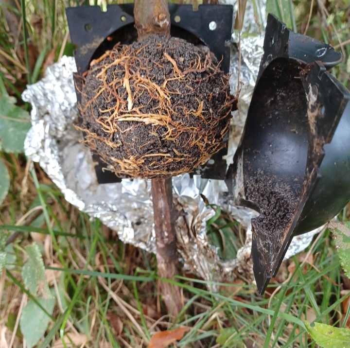

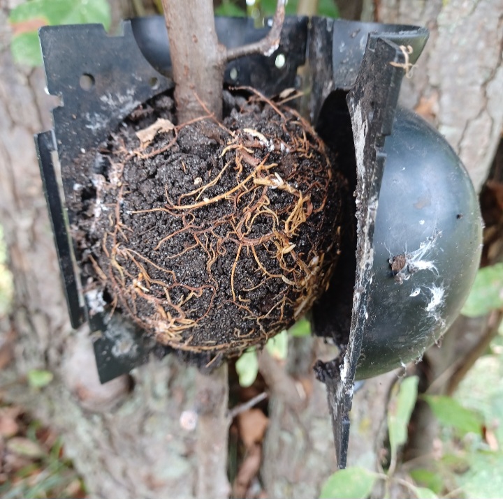

I need to remember to cut and pot up my MM111 apple rootstocks attempts. I keep forgetting about them and it's the beginning of August already. If I don't pot them up soon I'll have to leave them on the tree over winter until very early spring :rolleyes:

I potted up all 10 even the one with no visible roots. With them being cut free from the tree they are on their own. I'll know soon enough which ones will become root stocks for grafting early spring.
No visible roots have formed on the one on the right but it looks like it's trying to grow roots. So I potted it to give life a chance.
