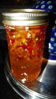

Habanero Gold
2/3 cup finely sliced dried apricot
1 1/2 cup white vinegar
1/2 cup finely diced red onion
1/2 cup finely diced red pepper
1/2 cup finely diced habanero peppers, with seeds or 1/4 cup finely diced jalapeno, and scotch bonnet peppers combined
6 cups white sugar
1 (3 ounce) envelope liquid pectin
Directions:
1
Cut apricots into 1/8 inch slices and measure into large stainless steel saucepan with the vinegar; let stand for four hours. ( I never do this, I start prepping while they soak)
2
Cut onions and peppers into 1/8 inch slices; cut slices into a 1/4 inch dice.
3
Add to apricots and stir in sugar.
4
Bring mixture to a full rolling boil.
5
Stirring constantly, boil hard for two minutes.
6
Stir in liquid pectin, mixing well and boil for one full minute.
7
Stir for about 3 minutes to mix solids, but put into jars before it gets too firm.
8
Pour into hot sterilized jars, dividing solids equally and fill to within 1/4 inch from top of jar.
9
Apply lids and process in boiling water bath for 5 minutes.
10
Once sealed you can rotate or invert jars while still warm to distribute solids if needed.
Originally from Bernardin but I doubled the veggies and converted instructions to sure jell liquid process.
Last nights batch

WOW! I'm rather freaking out at the thought of cutting up all those habeneros....DH is going 'hmmmmm', as he likes hot stuff.
Does the habanero gold have tons of heat like it seems it should?
sufficientforme
Oct 8, 2008
969
104
The apricot humbles them but in no way cuts the heat :D I use a garden mix usually jalapenos and whatever I have and it is fantastic!!! Heat lovers will love you!
My hubby usually sits down and chops with me but if he's busy I just use the food processor and it's done easy peasy, no tears or burning hands (even with gloves sometimes)
