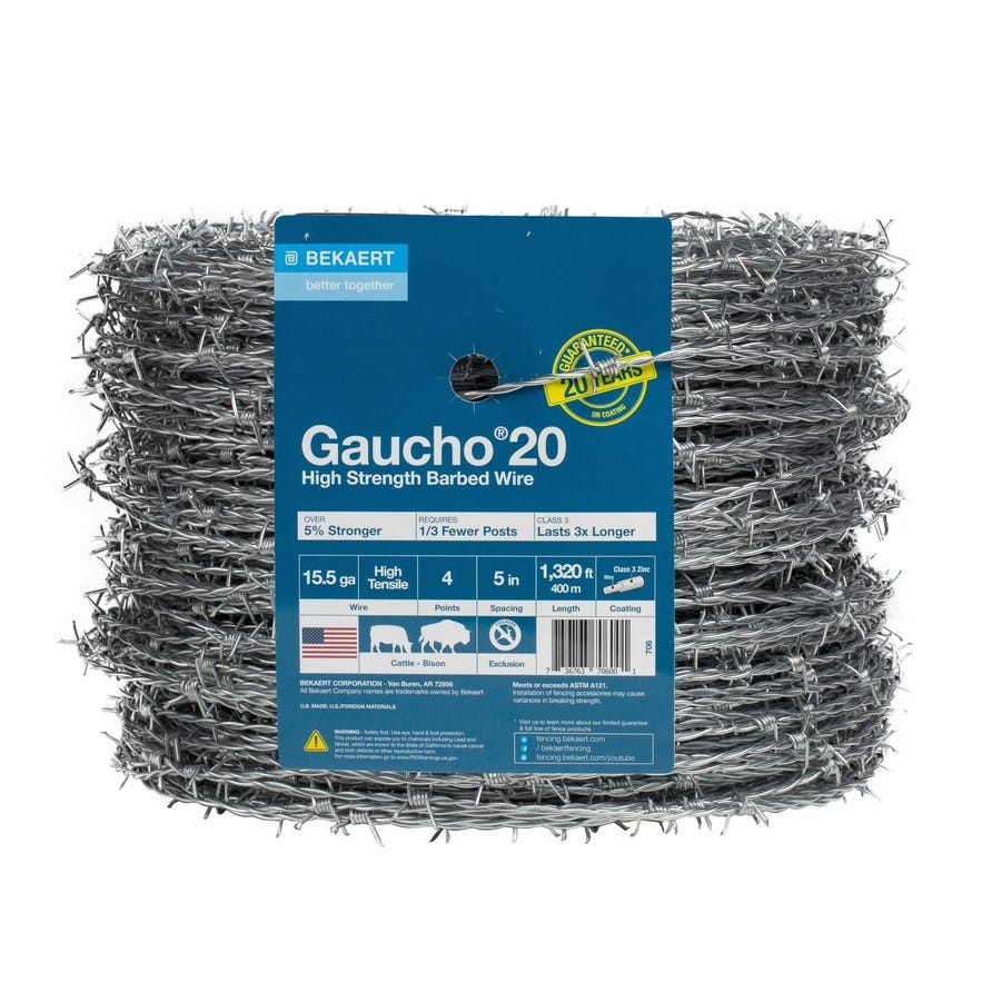

This is the barb wire I plan to use, it's for cattle and bison. Each roll is 1320 ft my 5 acres is 330 ft x 660 ft, my t-posts will be on 10 ft centers so 1 roll should get me 2 runs on the long sides or 4 runs on the short side (hopefully).
