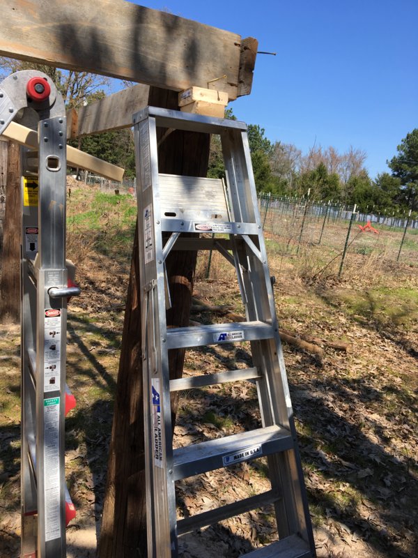

Today I put up 2x8’s on the sides, at the top. I had 8’ 2x4’s and cut off pieces, so I cobbled them together and made my rafters. Once again I used 2 ladders to hold up the boards.

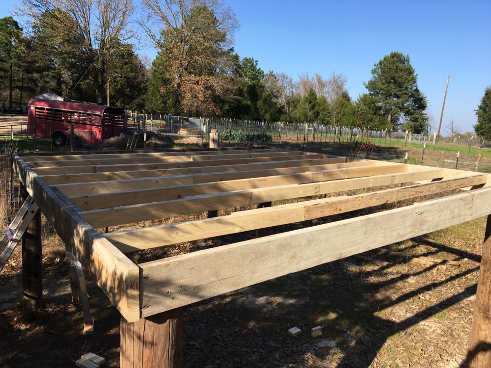

I got all my scrappy rafters made and put up. I’m tired. Tomorrow I’ll deck it, cover with tar paper and put tin on it. I climbed a ladder to snap a pic of the top.
Hey there do yourself a couple of big favors. Nail a full length 2x4 to the sill and tight under the the joist tails. That will stiffen the ends of the joists and help prevent them from falling under heavy weight. Also to prevent the center of the floor sagging, add a purling / some times called a summer beam under the length of the floor. Add a pier in the center of the summer beam also. You can.make a summer.beam by nailing several boards together to get the length like you did on the joists.

That's not the floor, it's the roof. I realize that it looks like a floor, because I climbed the ladder to get a good pic of it. The floor will be dirt.
I wish you were here to help too, I could learn a lot about building. I have no training, I just picture it in my head of what I want it to look like, then go about matching up what's in my head with reality-not always the same thing. LOL

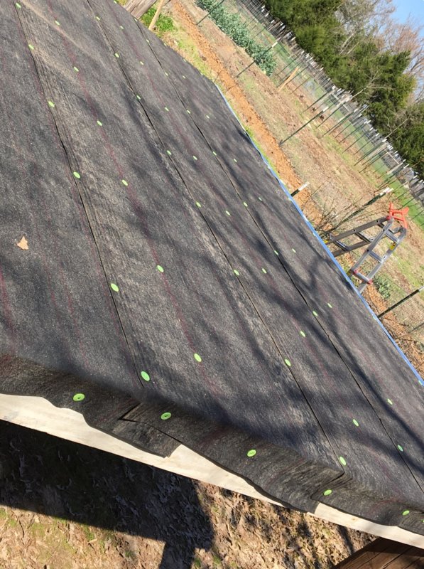

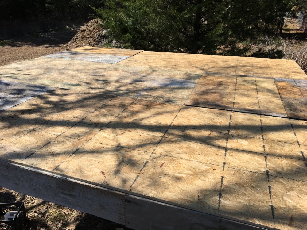

Our neighbor Robert cane over to help me with the deck. I couldn’t pick up those sheets of OSB and get them on the roof by myself. I had 3 full sheets and a lot of scraps. So we continued on with my Scrap And Crap building project. We off set the whole pieces and used 2-3 strips at the end of each whole piece. I scrambled around on the roof, Robert stayed on the ground.
Then we got the tar paper on it and I tacked it down. I had some bent metal drip edge that came in one of the reject lumber piles we bought, so I went and got it. We put it across the front.
