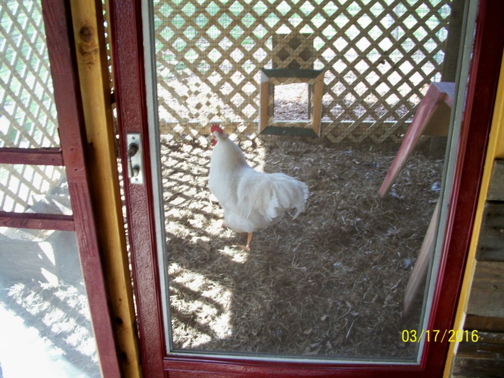

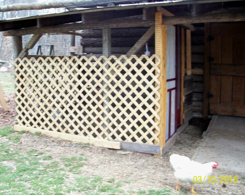

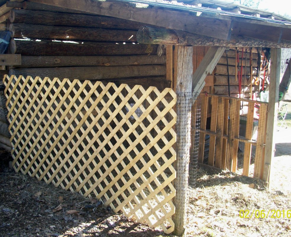

Here's my current maternity ward, the best I've ever managed to have, but constructed almost entirely of reclaimed lumber(FREE), scavenged materials, or very cheap materials. Before that, this was just a space to store lawnmowers and tools and has went through a few changes over the years to finally get to this state of being. The dogs like to sleep and lounge there in the winter months and I store hay there then too. I also use this pen as a holding pen for free birds out of local ads that I kill for meat, for penning the rooster to give the hens a break, for breeding certain pairs, for breaking broodies, etc.
I really need a good way to section it off for broodies in different stages of brooding eggs and chicks but haven't gotten around to that yet. But...I will. ;)

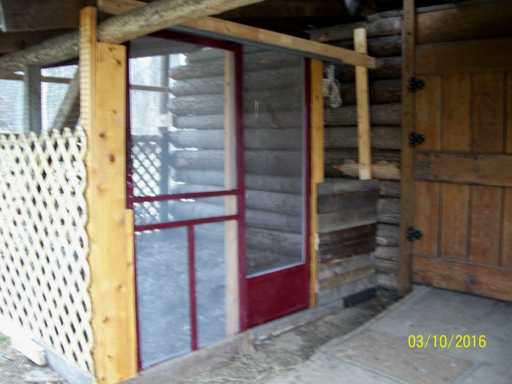

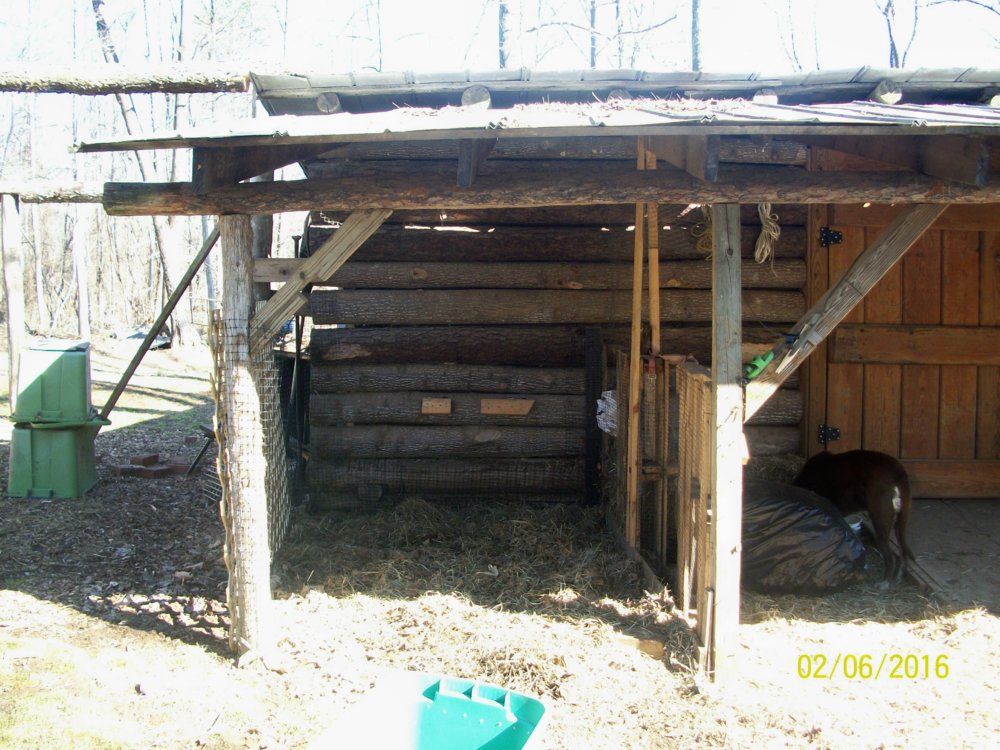

I had previously built in this side of the shed porch with pallets and reclaimed lumber, but that wasn't working well.
Now it all looks like this...the main door slides on a track and can be lifted off, while the other door is on hinges, so both can be opened for better access.
