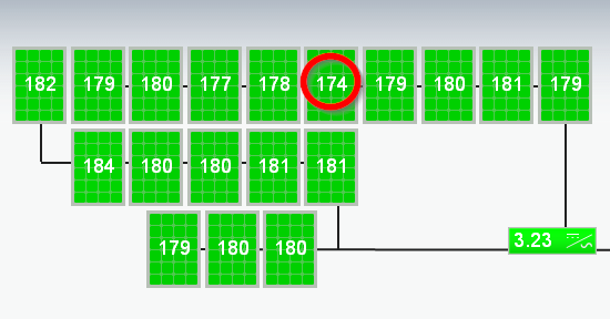

I was looking at my data on my solar panels and I kept seeing this one panel consistently under-performing compared to the rest.
I of course know that different panels have different efficiencies from during manufacturing, but this one had never been a problem before.

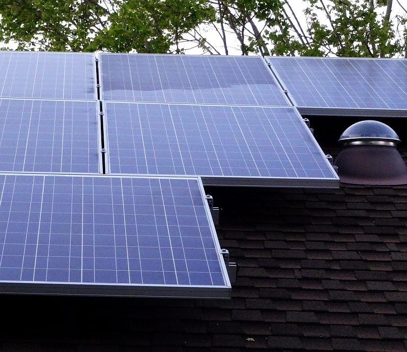

So, for a few days I've been meaning to go outside and take a look at the panel to see what I could find, and I saw this:
So, it looks like when I cleaned my panels a few months ago, I didn't do a very thorough job on this one panel, and it's obviously making a difference! You can see the darker areas at the top of the middle panel where the dirt is causing the panel to be less shiny.

Interesting. But it definitely makes sense that a solar panel not receiving as much solar energy as its neighbors would not work as well
