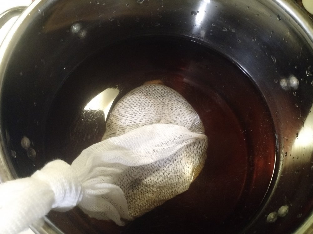

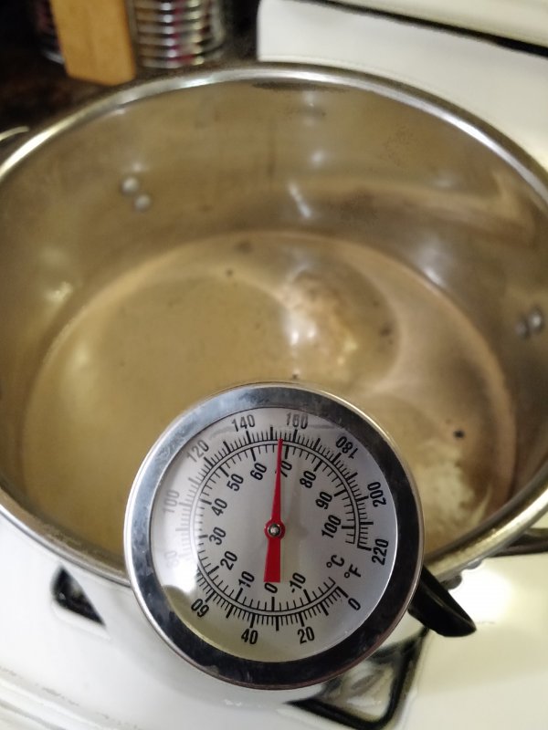

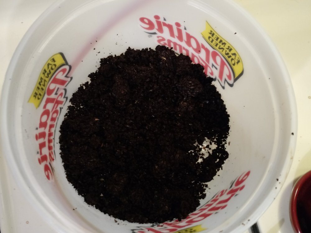

Add a gallon of spring water to a 3 gallon kettle. Put the crushed Chocolate Malt in a muslin bag and tie a loose knot in the end. Begin to heat the water to 155 degrees
Maintain as close as you can to 155 degrees for 30 minutes (150 to 160 is good).
Start your kettle with 3 gallons of spring water and stir in 6 lbs of Munich and 1 lb of pilsen light dried malt extract.
Stir the kettle often to avoid scorched malt to the bottom of the kettle. Take a little taste of the malts oh how sticky sweet they are.

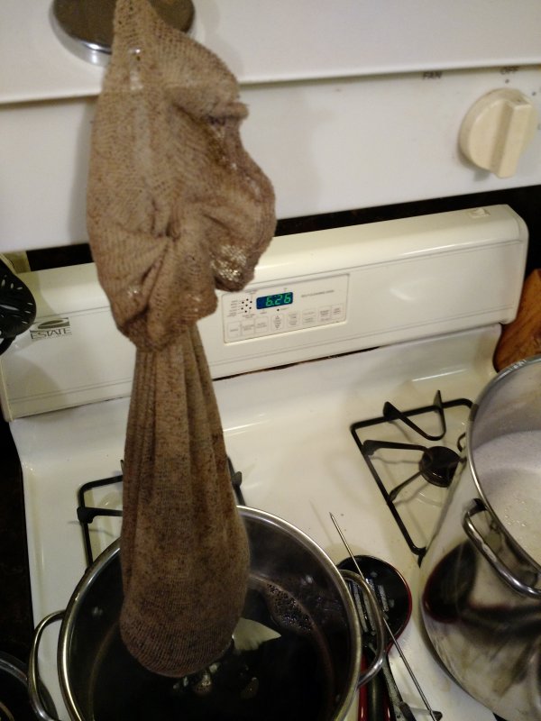

At the end of 30 minutes cut off the flame under the chocolate malt (if it's on) and suspend the muslin bag of chocolate malt above the smaller kettle. Allow it to drop back into the kettle. Pour 1 gallon of room temperature spring water through the muslin bag and also allow to drop back into the kettle. Squeeze the bag like you bought it to get every last drop of chocolate malt into the kettle.

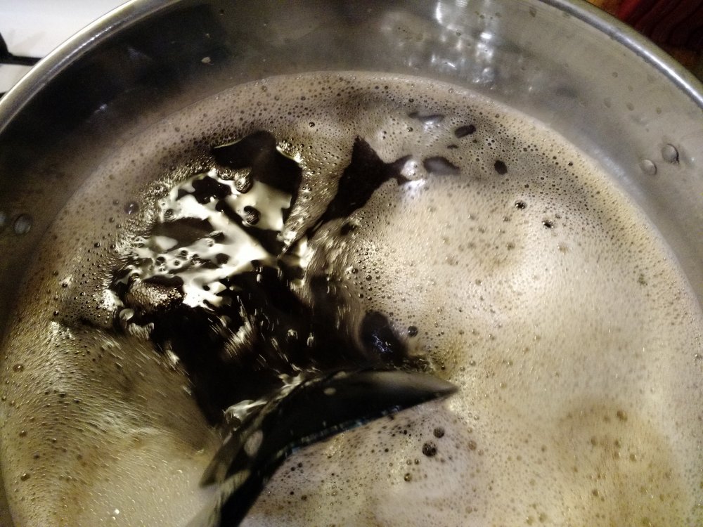

Now pour the chocolate malt wort into the large kettle of Munich and Pilsen. You will now have approximately 5 gallons of Dark Bock wort to heat to boil.

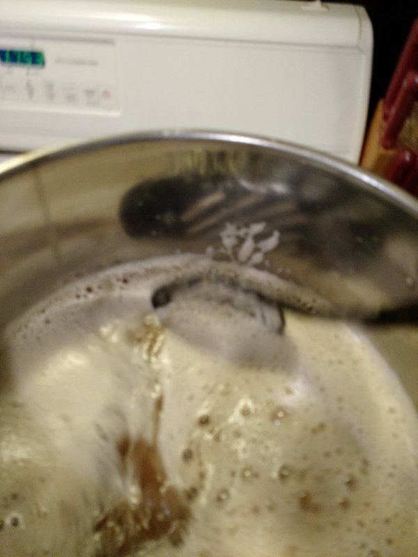

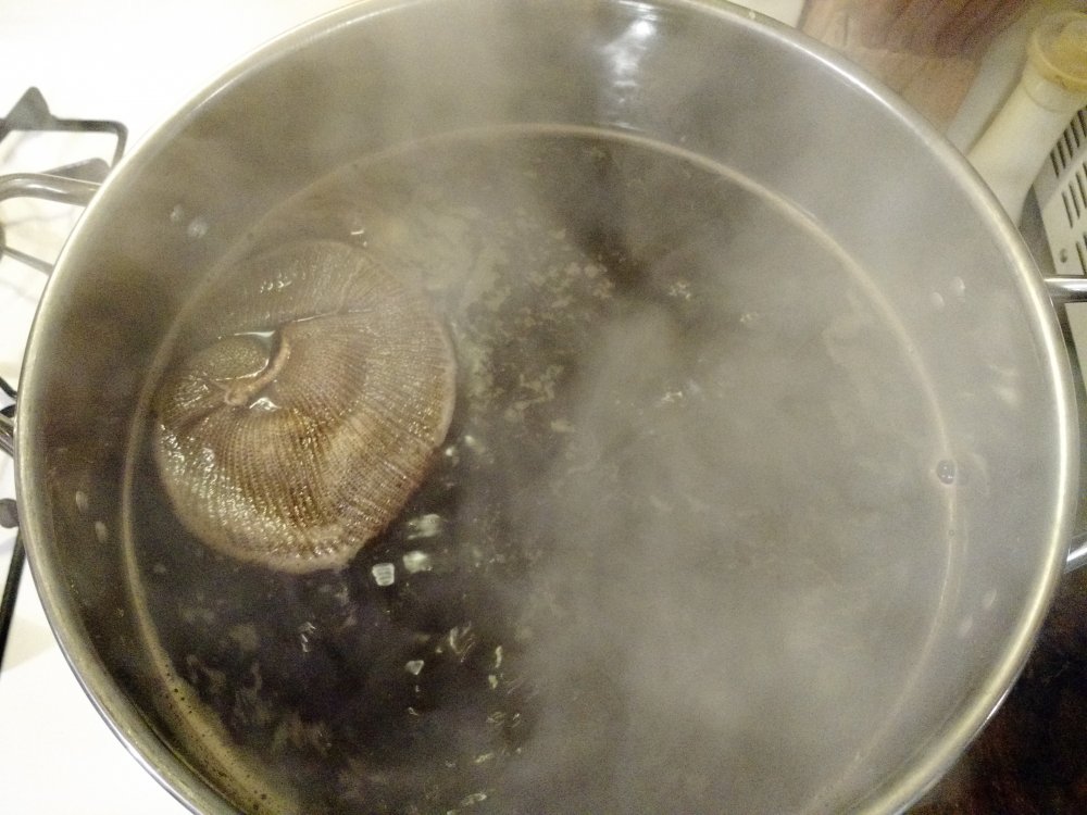

Once boiling starts (stir often) add 1/2 ounce of hops in a small muslin bag and set your timer for a 60 minute boil. Stir often all the way to the bottom to avoid scorched wort. Kick back and relax, enjoy the smell of the wort boiling and man it's so sticky delicious sweet.

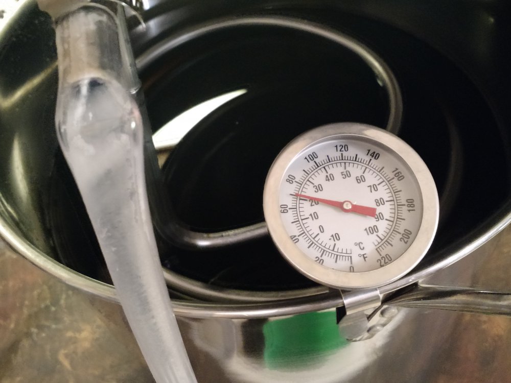

At 50 minutes into the boil (with 10 minutes left) add the clean emersion chiller to sterlize it. At 60 minutes or flame out hook up the chiller to the sink and start cold water flowing through it. You'll want to contine to chill the wort into the mid 60's. Close enough...

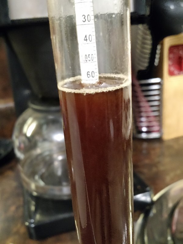

Starting gravity 1.062, this beer should ferment out to about 6%ish ABV

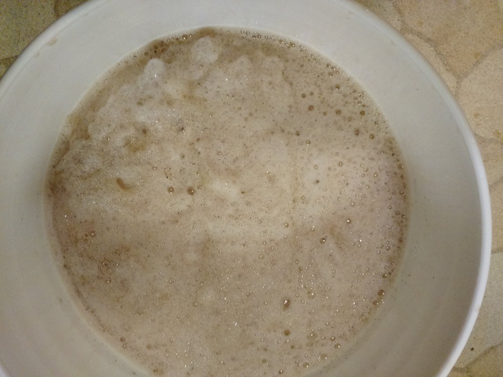

My Dunkel Bock has finished primary fermentation. 9 days is about right for a 6ish ABV lager brew, fermented @ around 52 degrees. A sniff of the air lock smells like beer, that's a good sign :) now at least 3 days for diacetyl rest at room temperature and rack into a corny keg for lagering.
diacetyl tastes like butter, the diacetyl rest at room temperature allows the yeast to convert diacetyl into other compounds.
We don't want no butter flavored beer.

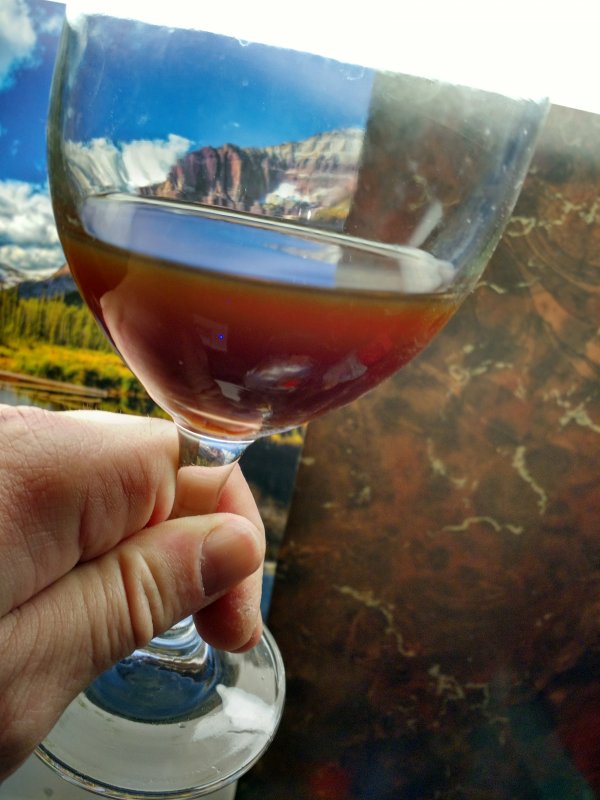

After diacetyl rest, it finished fermenting @ 1.014 which puts it @ 6.30% alochol by volume on the nose. It tastes great, almost but not quite like a S'more. It's missing smoke and not near as sweet because most of but not all of the sweetness is offset by the bittering hops addition. But it does taste a lot like a S'more. Gramcracker, marshmallow and chocolate is the first thing that came to mind when I tasted it. It's very well balanced and smooth for green beer - Yum. It will be interesting to see how it finishes after lagering and carnbonates, but right now this Dunkel Bock recipe is a definite keeper.
