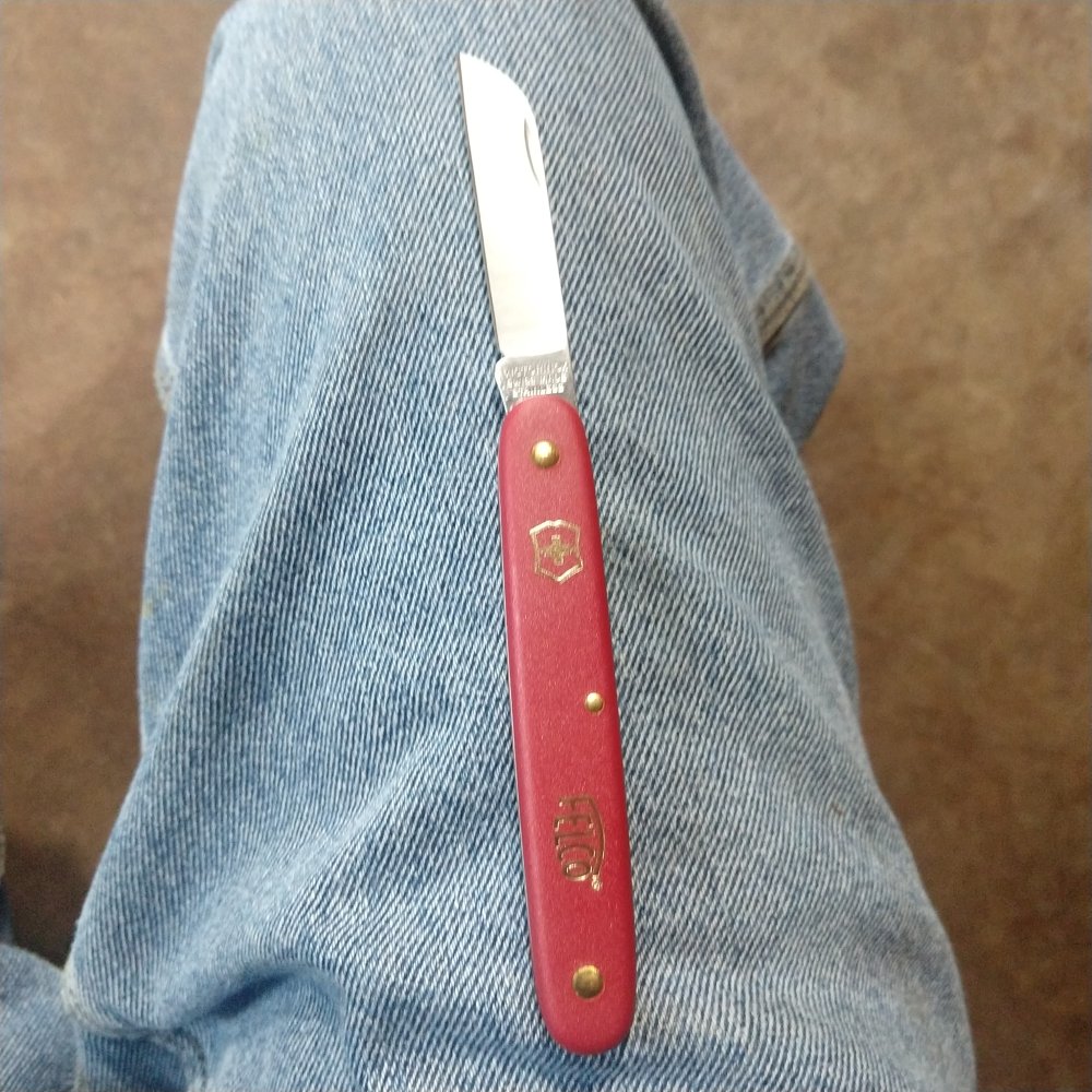

My first ever grafting knife, nice 👍 it's larger than I thought, comfortable in my big hand, blade thin stainless steel and single beveled like a straight razor. I believe I could do some good grafting with this knife.

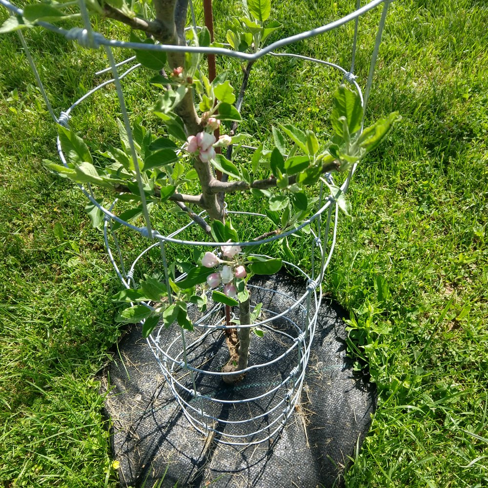

Starkbros Red Delicious Apple I planted 3 weeks ago. It was the 3 to 4 foot bare root, semi dwarf. I can't be certain, but I suspect this was chip budded onto M111 root stock.
Surprised to see flowers on it already. Ofcourse it won't make any apples this year because all the pollinator apples have already bloomed and set fruit. But maybe next year I might see some red delicious apples from this tree.

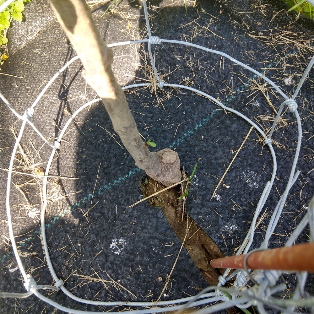

Here's the Starkbros graft. Looks like a chip but graft 2 to 3 years old. You can see where they cut the Rootstock just above the graft. When planting new grafted fruit trees it's important to not bury the graft. Leave it 2 to 3 inches above the soil. Burying the graft is the most common mistake made and results in mortality of the tree.
