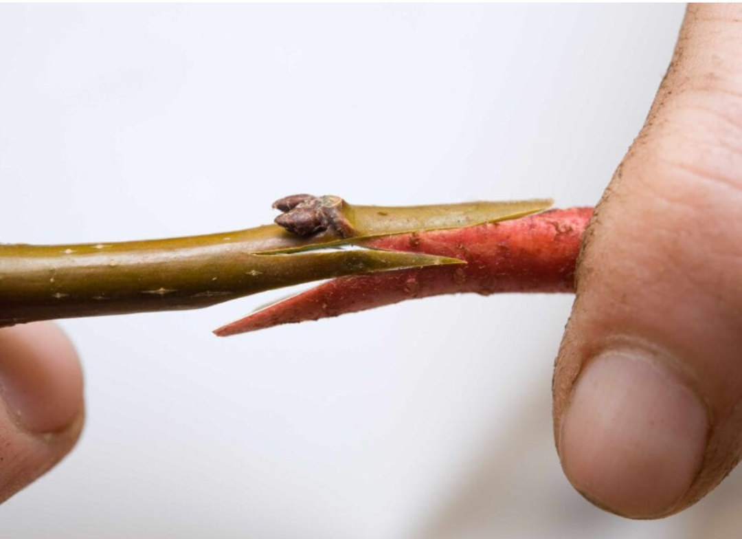

This photo show the whip and tongue graft joint pretty clearly, because different colored bark. My initial thoughts It's kind of like fitting jigsaw puzzle pieces together. It's just wood I can do this. Will I make mistakes? Absolutely I will, that's all part of the learning process. Besides experience is a strange thing, you get it right after you needed it. Now where to find a good quality grafting knife, so I can practice and make mistakes 🤔

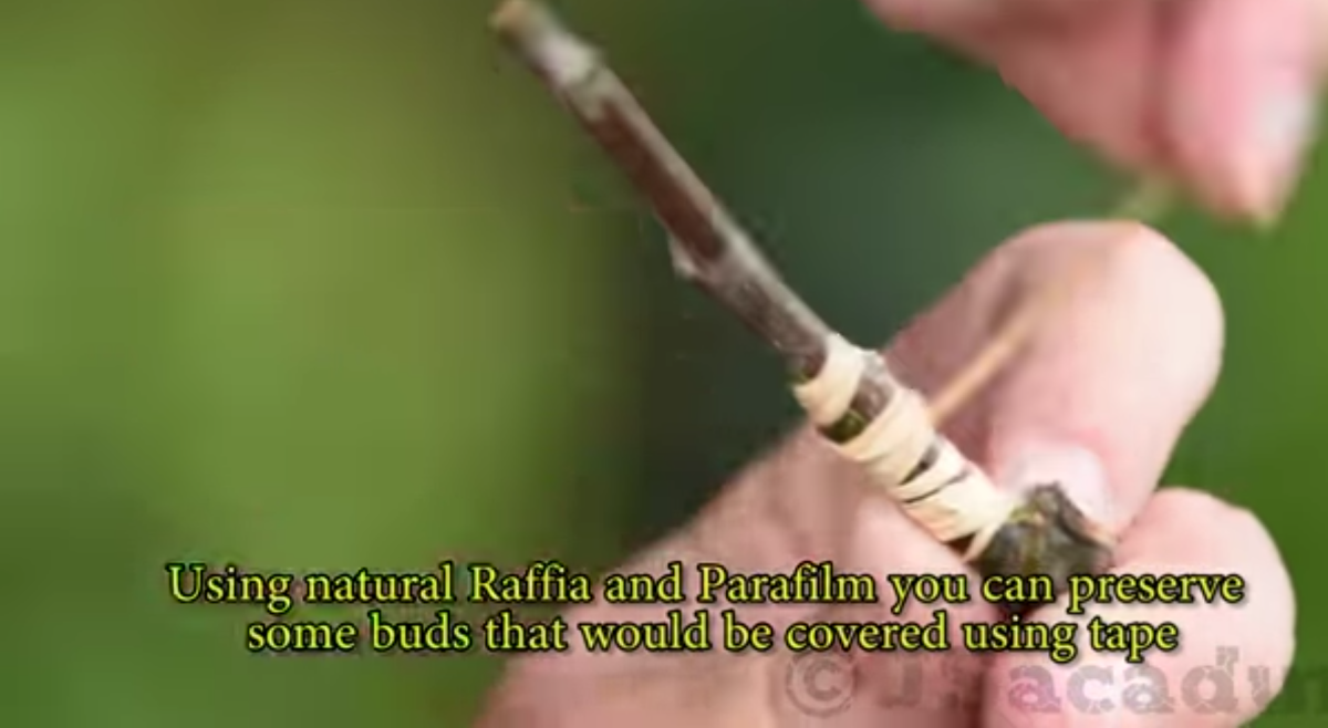

Using biodegradable materials (raffia & parafilm) to secure the graft while it heals, makes perfect sense. Screen print at 7:27 from the video.

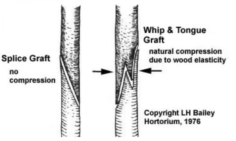

Whip and tongue - good compression graft joint.
