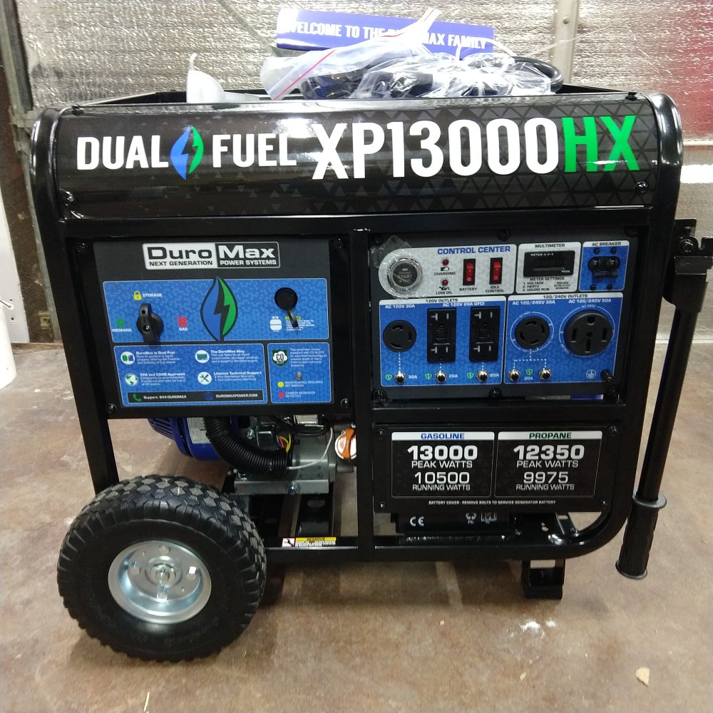

The thing is a hawse. Tomorrow I'm gonna fill it with valvoline 10w30 full synthetic and some 89 octane and give it a test fire.

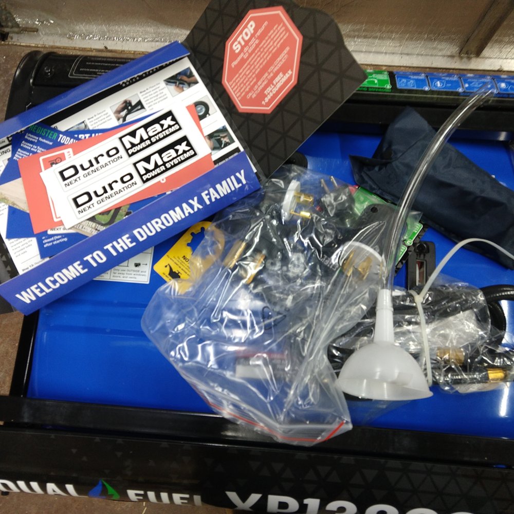

it comes with steel body parts including the gas tank. A battery for electric push button start plus a recoil (pull rope) starter. It also comes with oil filler tube and funnel, all the electric plug ends, propane hose including regulator for propane bottle operation, a cheap tool bag full of cheap tools to assemble it and manuals, maintenance log book and SWAG (stickers).
I'll post more about it after the test fire. I hope I'll never have to use it, but it's good to have one.just in case you get into an emergency situation.

The thing is a hawse. Tomorrow I'm gonna fill it with valvoline 10w30 full synthetic and some 89 octane and give it a test fire.View attachment 18152
dont fill it with passenger car motor oil. it doesnt have anough zddp and will cause damage and excessive wear. use a heavy duty engine oil like rotella, or delo 10w30 or sae hd 30 or 15w40. i run 15w40 in mine but i live in texas where it doesnt get too cold often.
also unless you wanna rebuild the carburetor often i suggest filling it with non ethanol gas if you can find it or just run it on propane. ethanol gas will rot the carb if it sits.
Thanks for your wisdom ✓
