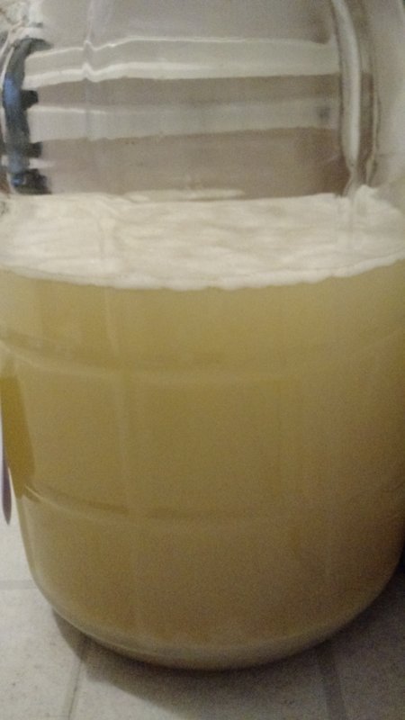

Day 3 - nice peacefully top ferment going on in there. The bug yeast seems happy chewing though the sugars and producing co2 & alcohol in its wake.
There is a fair amount of sediment (trub) dropping to the bottom already, which is good.
No visual evidence of any secondary infection. Sanitation is #1 rule of thumb when fermenting. So far so good, fingers continue to remain crossed.

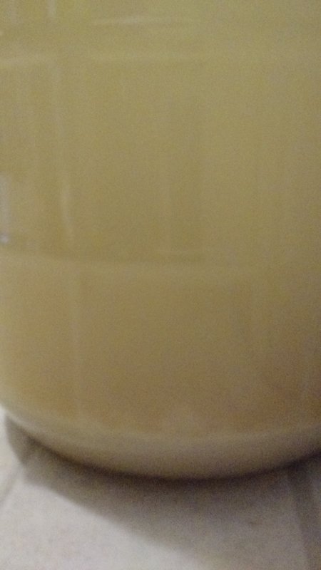

Day 4 - just beginning to die down. Trub is getting deeper in the bottom, which is good. No visual signs of secondary infection. So far so good. Looking forward to drinking some, I'll most likely bottle Friday. Then I can have a taste test of flat beer.

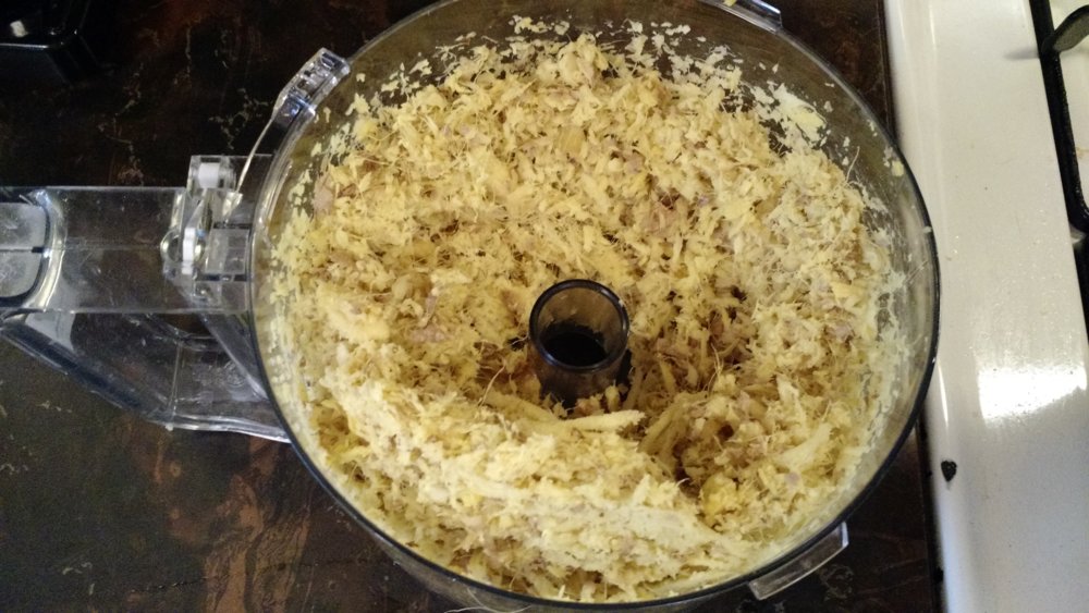

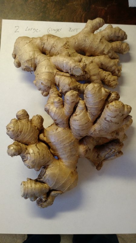

1lb Fresh organic ginger root
Ginger root shredded with food processor

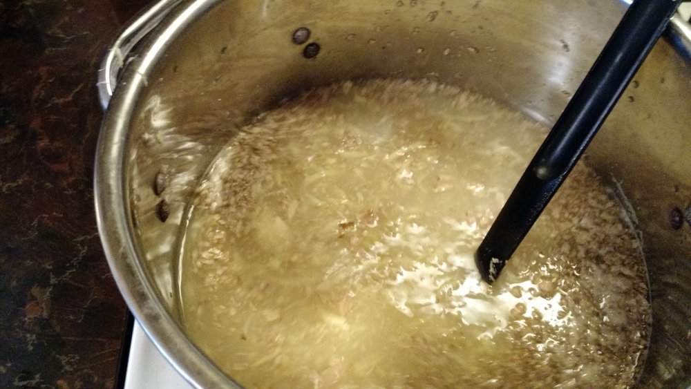

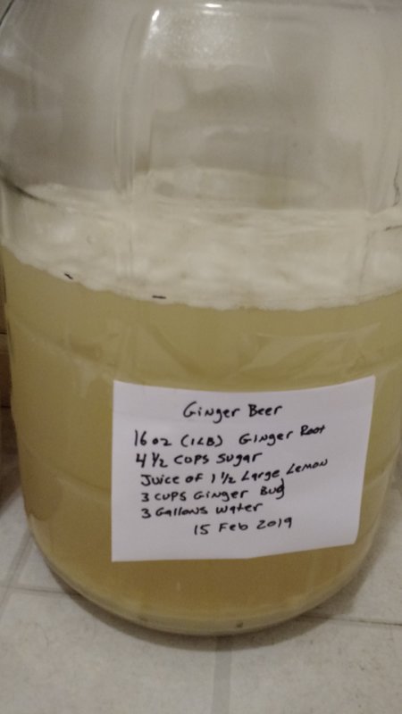

Boil ginger root & 4 1/2 cups white sugar in 1 gallon water for 30 minutes. Allow to cool.

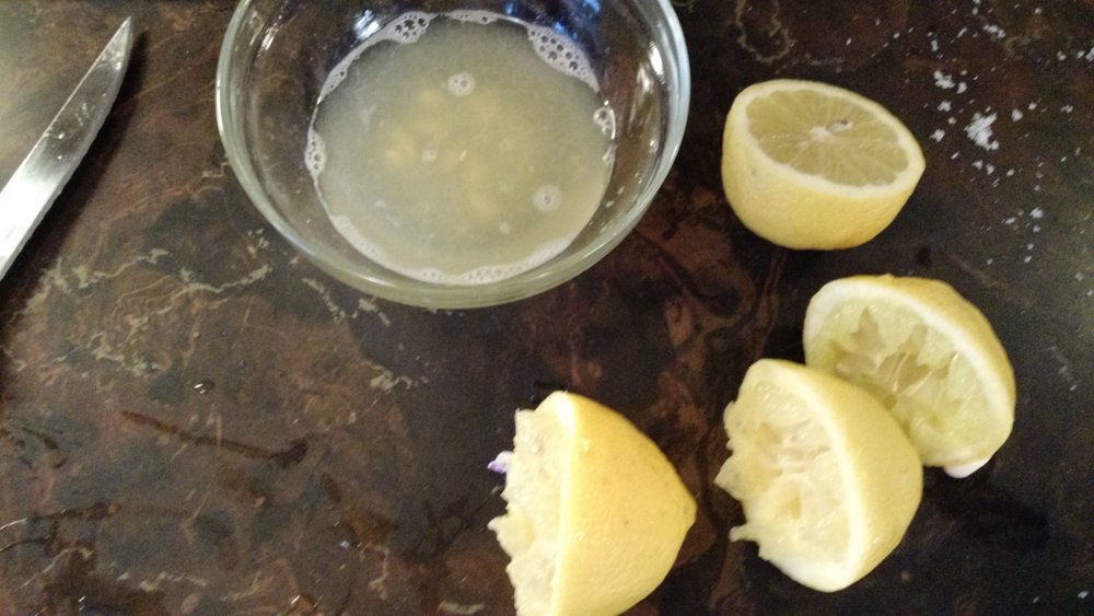

Add juice of 1 1/2 fresh lemon to pot through strainer.

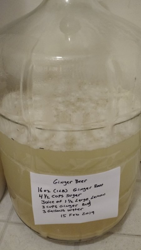

Pour into carboy through strainer, add 2 gallons water. Shake carboy for 5 minutes to airrate. Add 3 cups strained ginger bug juice. Install bung and airlock. Sit in a dark place that will see no sunlight. Don't touch, cross fingers and let it do what its going to do.

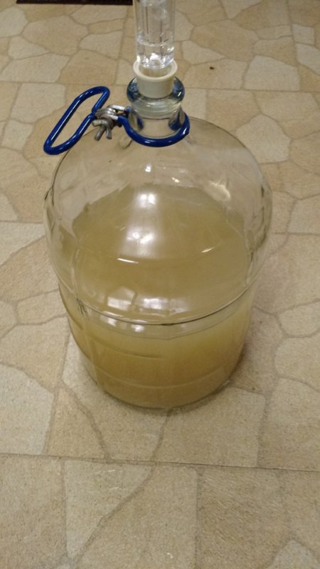

Day 5 - some notable condensation forming inside the carboy. This is totally expected and means there is alcohol present. Alcohol floats on top of water, where the top feeding bug yeast is present. As the bug yeast produces co2 there is a tiny amount of alcohol within the gas. As the gas hits the side of the carboy, the alcohol collects as a vapor. gravity will cause it to run back down into the beer.
If you look right below the bubbles there is a line of alcohol, might be hard to see in this picture though. Again no visual signs of secondary infection and no off smell when I sniffed the air lock. So far so good :)
