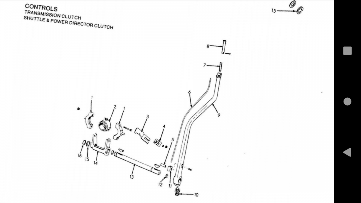

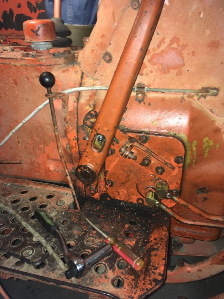

Here's the parts diagram for the power director clutch. The tractor was missing parts 5 & 11 plus the set screw.
Without these parts you couldn't lock the power director clutch into nuteral. This is a safety feature. Because when in nuteral no mater what you do to the gear shift forward of backward it won't move at all. Here's what the power director does.

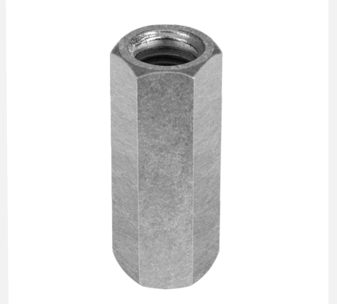

You know you just can call AC and order parts for a midyear 1962 D19. So after looking at the pictures and taking some careful measurements, I had an idea of how I would go about making the missing assembly. Sometimes my ideas are good other times well not so good... This time my idea was good.

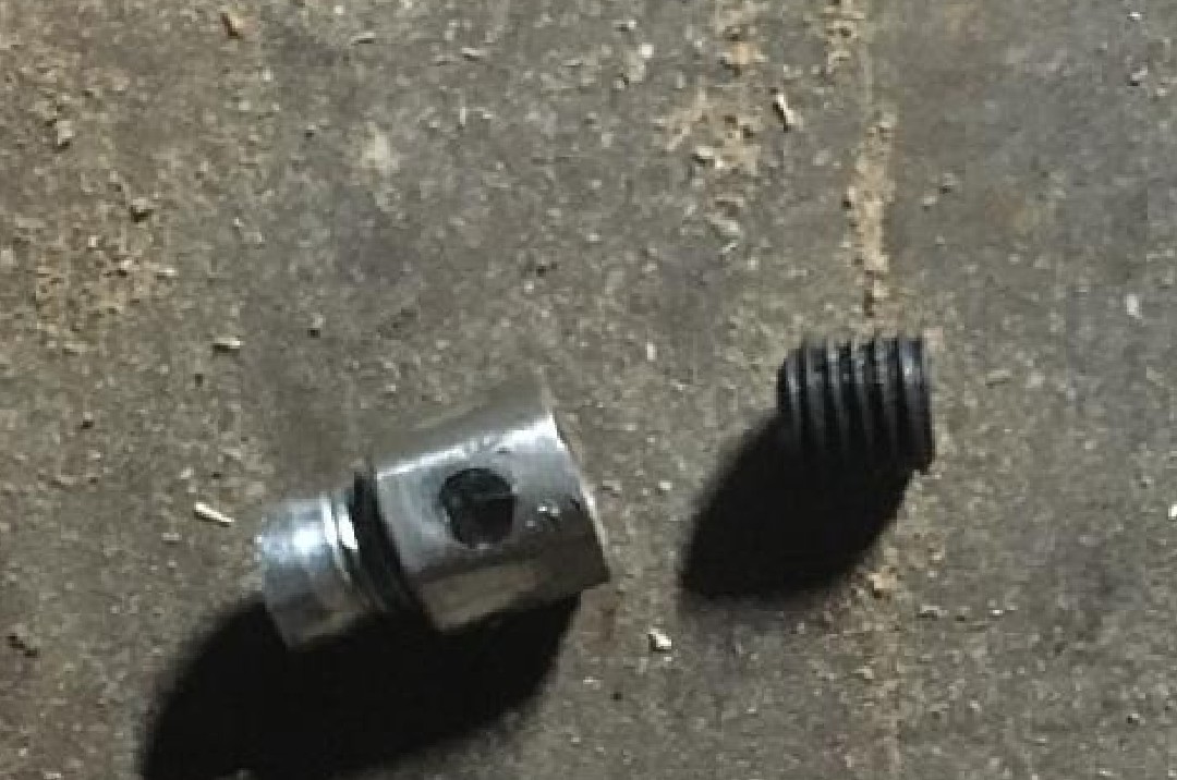

I went to Rural king and bought an assortment of 1/2 13 bolts, setscrew, washer and a coupling nut.
We cut the coupling nut to the length we needed, the cut a bolt to the length we needed to make the pin. We used a long bolt and cut it on both ends so the pin sticking out of the end didn't have an threads. We then ground the coupling nut round and drilled a 1/4 hole through it for the rod. After we got the rod through the hole in the coupling nut we tightened the assembly down with a setscrew just like is pictured.

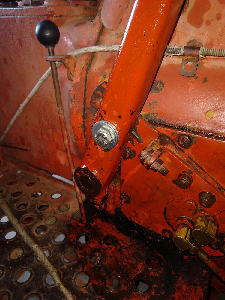

Our barn made Fab job worked but occasionally it would get bound up because the rod is formed spring steel and quite floppy in the lever. My suspicion is this is why the assembly was removed in the first place. It could have used a little better engineering. You know I'm not one to give up so easy... So after a little more though, I swapped the set screw out for a 1/2 long bolt and two washers. It pinched the spring steel rod just as well as the set screw did and now there's no more binding. You push the button and it goes right out of nuteral when you pull the lever forward or backward. If you bump the lever accidently it pops into nuteral without having to push the button. I think I built a better mouse trap than the engineers at the factory did.
Here's the first assembly based on the parts manual and picture of the tractor. It worked but just not good enough. And it installed in the power director clutch lever. If you compare the black and white photo to my photo you'll see the assembly looks the same.
Here's a better engineered design. it's loose enough to slide the assembly in the slot when the button is pushed but tight enough to hold the spring steel rod in place and slide up and down as it should by pushing the button on top of the lever.

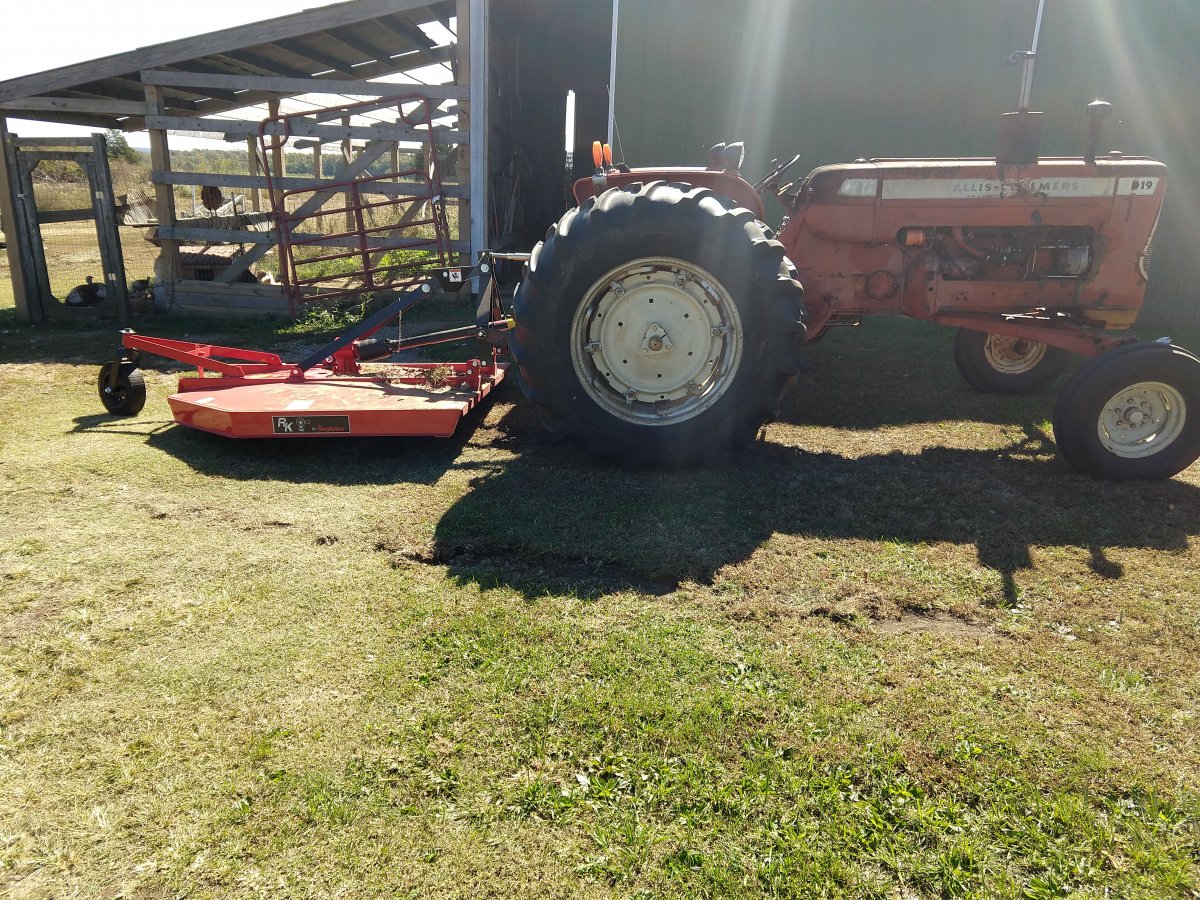

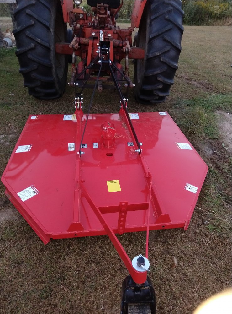

Now rural King that's another story, the place was PACKED... I waited 4 hours to get my new 6' bush hog loaded on my trailer. The loading didn't take so long. but them finding the driveshaft did. Apparently they put the drive shafts in the warehouse in the deepest darkest corner with half the werehouse stacked in front of them so no one will ever be able to find them again. By the time I got home and got it hitched up my wife rang the dinner bell. After dinner it was starting to get dark so I didn't get a chance to hook up the drive shaft.
Today was not very productive at all. But it could have been if they could have found the drive shaft quicker :( oh well at least the hog is Made in USA so I feel good about buying it.

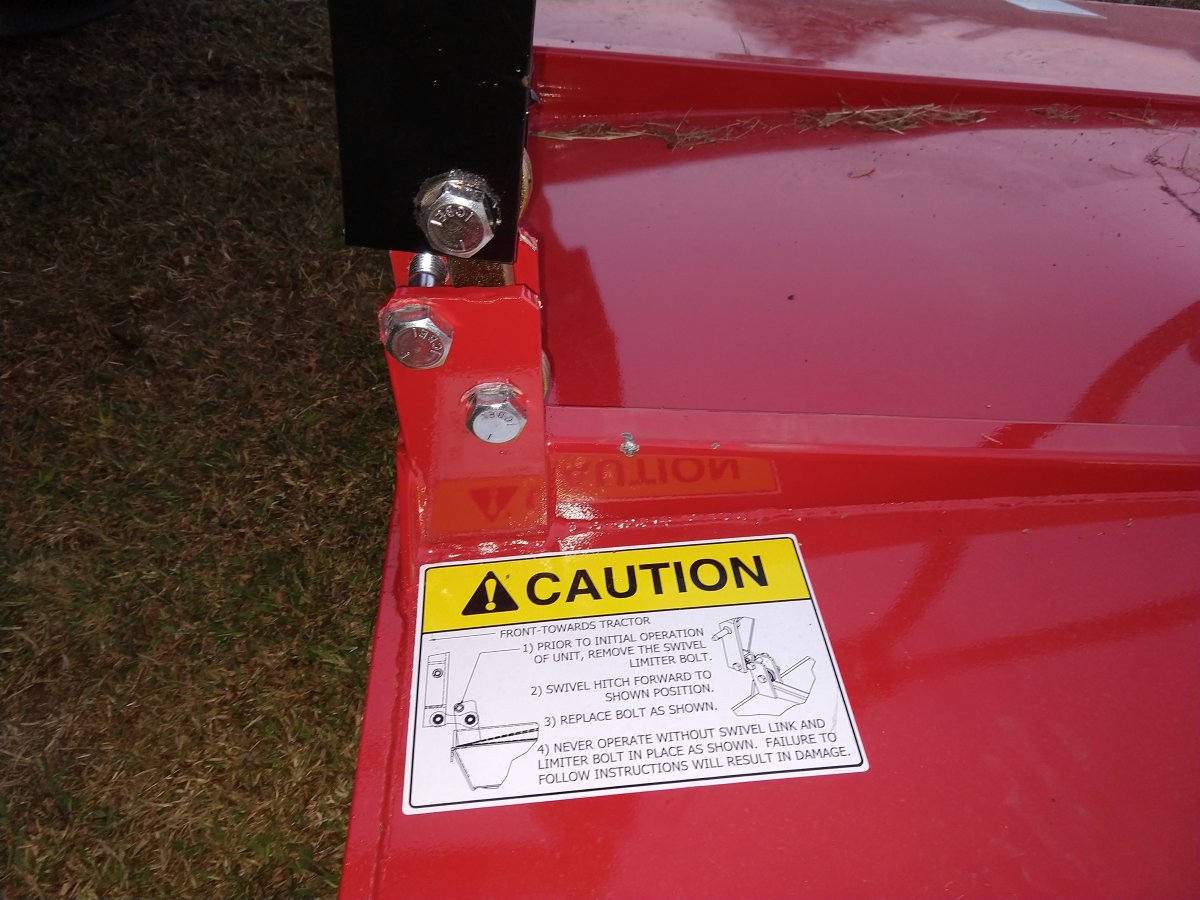

Here's as far as I got, then I happened to notice this sticker, uggg...
See what I did wrong?

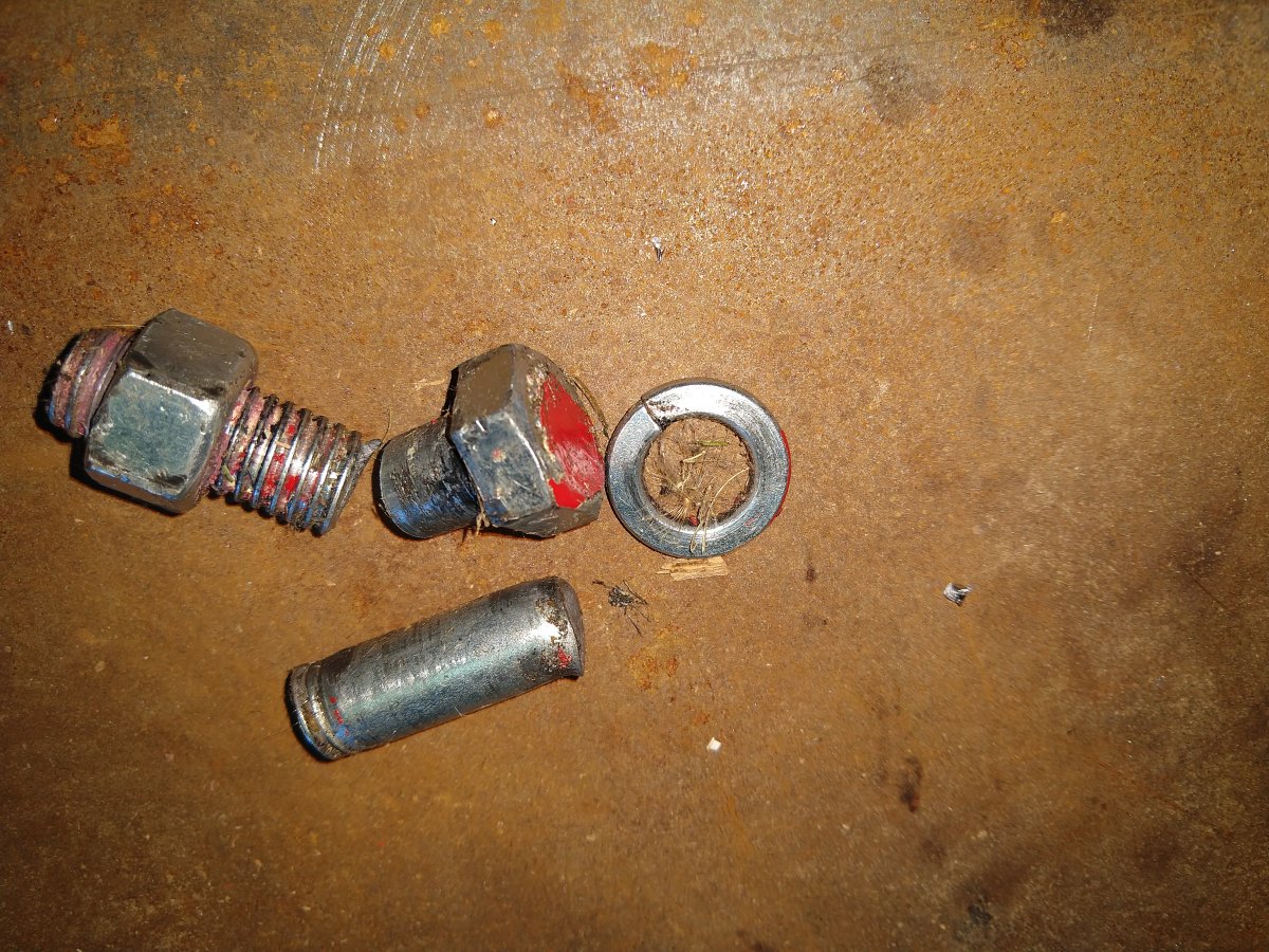

Bush hogging didn't go so well. I snapped the sheer pin (soft bolt) and the shaft pushed forward into the yoke and crushed the grease fitting. I couldn't get the shaft to come out far enough to get a new sheer pin in. After beating with a little hammer, then a bigger hammer and finally my 10 lb slege hammer. I tightened up the top link and backed it up to my trailer. Disconnected it and took it back to rural king for an exchange. I have another one on the trailer to assemble again, horray...
In all honesty the two ding dongs that loaded the first one beat it up pretty bad and I think they bent a blade with the forklift. They also busted the tail light on my trailer. But I do understand things happen... so I'm not going to say anything about it. I helped the guy load the new one this evening and we didn't beat it up at all, unlike like the two ding dongs did yesterday. While I was there I bought some grade 5 1/2 x 3 1/2 bolts to use as a sheer pin on the new one.
anyways here's the old one and the broken drive shaft sheer pin (soft steel bolt). I believe I had the hog level enough. Everything was going well, then I heard a big SNAP and sure enough the sheer pin sheared. Lord willing, tomorrow is another day.

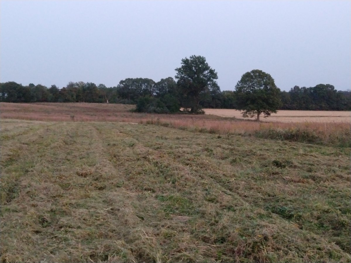

Amazing the critters you see bolting out of the tall grass. I ran out a family of Bob white quail. Countless rabbits, deer oh my Lord they are thick, they must like tall grass to bed in. I must have hogged over 30 plus beds and fox wow they are thick also. I lost count how many I seen. I seen so many I was able to get a shaky photo of one with my cell phone while hogging.

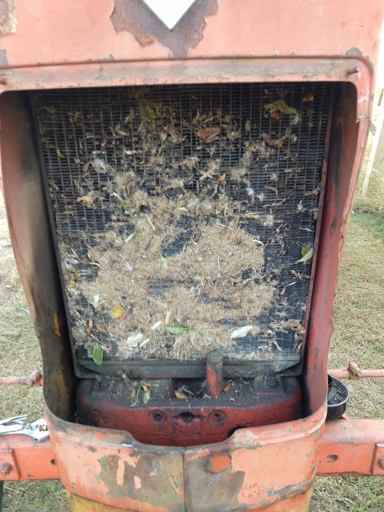

Now I know why there are 4 thumb screws to remove the grill and gain clear access to clean the front of the radiator. You can also see the bare metal on the bumper from running through the parire grass. Yes, I asked a lot of the old girl but she put in a day's work and didn't even think twice about it.
With the parire grass knock down, I can see a lot more. Like 3 deer on my neighbors 40 and geese making a ton of noise.
Still got a lot more hogging to do. I bet the old girl would pull a 8 hog without even blinking. I got way more tractor than I need, but bigger is better and besides when in doubt, double the stout. I need a shower something awful. I'm still picking grass seed out of my ears.
