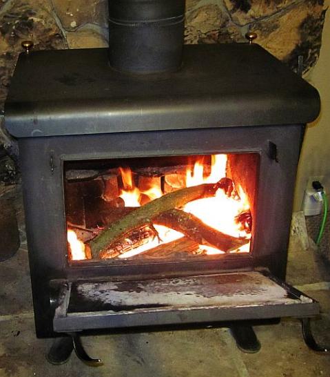

Well, until I decide what to do I'm just gonna keep using our old and inefficient wood stove:

I STRONGLY suggest against one like in the picture!!! It is asically a "campfire in a box" and is super inefficient.
The new stoves are a bit more expensive but, if you plan to heat with wood, you're much better off getting one of the new stoves that has a secondary burner! Basically you get a lot more heat and produce a lot less pollution for the same amount of wood.
www.englanderstoves.com has models available at Lowes, Home Depot, etc.

I have to agree. We just got rid of our old, inefficient stove and the new one is heating the entire house on very little wood. Sure, we haven't hit real winter yet, however, the difference is startling. With the old stove, we could burn that thing full blast and we still froze, huddled on the couch a few feet away. Most of the heat went right up the chimney. We kept the door open on it all the time we were home to get it even hotter. We went through a LOT of wood (at least a large wheelbarrow-full a day) and still shivered. It cost us about $2000 to heat our 1400 sq ft home last winter.
On a very cold fall day....20 F in the AM and up to the 40's later, windy and rainy and damp....3 five gallon pails of wood keeps us toasty all day long. The thermostat has been OFF since we got it. I suspect we got way too much wood at 6 cords, but we got what we did based on running out by the end of Feb or so last year.
This stove will pay for itself by mid-winter. I thought it would take the entire season to pay for itself, but I hadn't counted on selling the old piece of junk for half what we paid for the better one!
