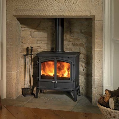

I currently use one of the fancy glass door types that get sold commercially. It looks a bit like this, with the chimney coming out the back:
I found it helps if I open the doors every so often to let the heat out into the room, but then I have to watch it, because the logs spit the odd spark out and I don't have a fire guard. Those things I found also block a LOT of the heat from the fires.
