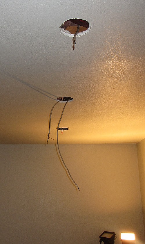

Today was a busy day! I decided to go with 3 recessed LED cans right down the middle of the room. I figure if I need more light I can put the fan/light combo in the middle of the room... but I don't think I'll need that much light.
My wife's dad and I wired the switch and I cut the holes for the cans, & wired them up to each other. Tomorrow I will make the connection from the lights to the switch and then I'll finally be past the big hump that's been keeping me from moving into my new office! (the next hurdle will be choosing / installing the flooring).

BAD NEWS:
I'm so upset! I turned on the LED cans today and they have a slight buzz coming from all of them. I called the company and they said, "they shouldn't buzz more than florescent lights." Um... I don't want ANY buzz at all!
So, now that I spent half a day wiring and installing these dumb things I need to decide if I either remove them all and return them for something else, or if I just live with the slight buzz.
