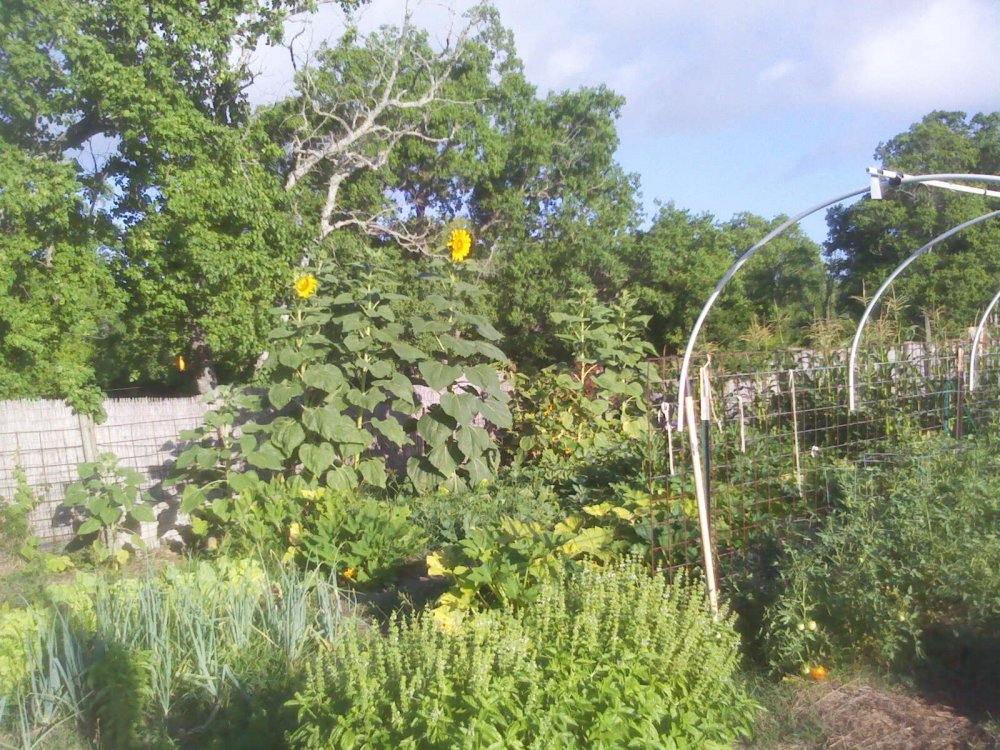

Found a garden picture before using "murderous" mulch.
