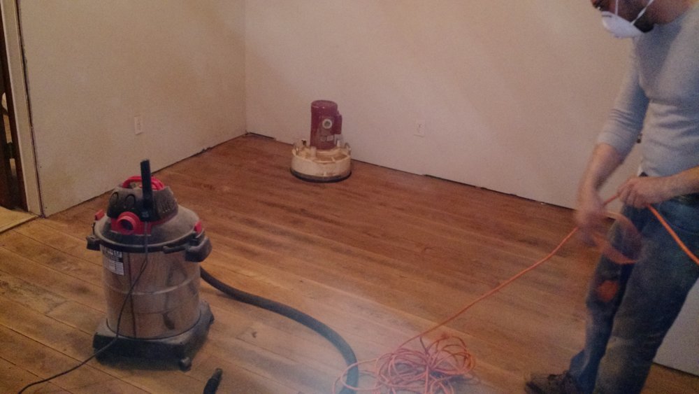

My son in law running the edger

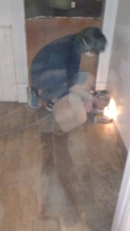

My son running the floor sander. It helps to have someone with experience. He took the floor sander apart and ran just the head. Doing so made it work a lot better (floor sander hack -:lol)

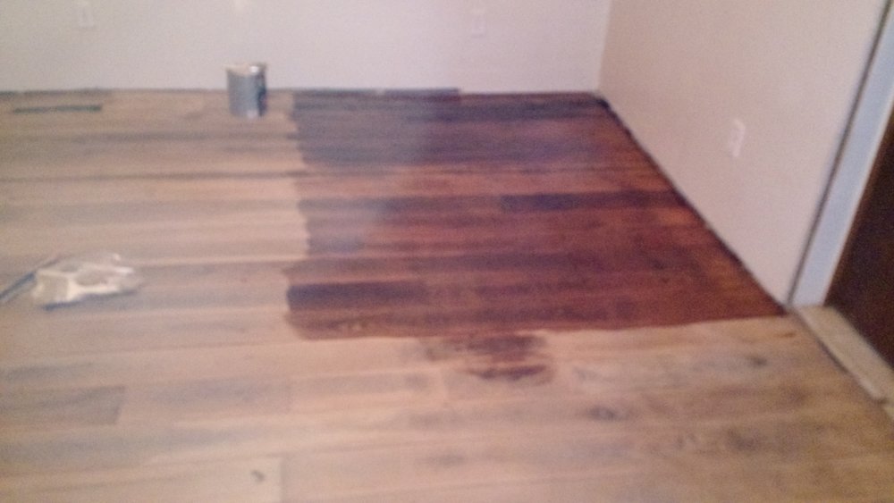

I couldn't resist... after the first room was done being sanded. I just had to see what it would look like with a coat of clear gloss oil based polyurethane. So I brushed on a small section and it about blew my mind. This is what old growth white oak looks like with a clear coat of polyurethane.

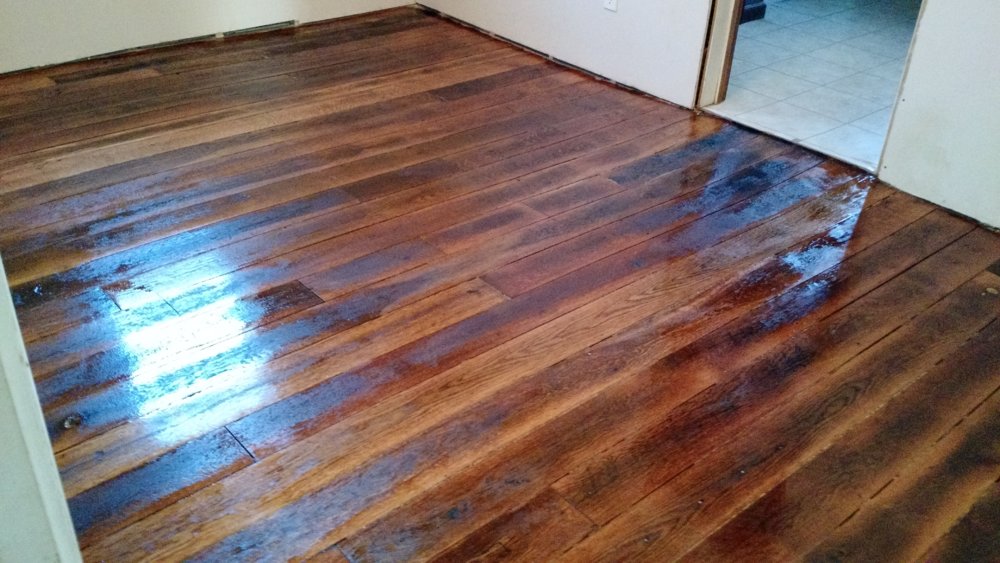

I got the first coat of polyurethane down on the two rooms and hallway.

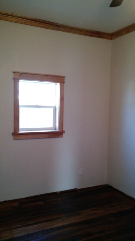

And I've finally decided on trim. My take on Craftsman style trim. Its really easy to make in the shop and I think it kind of goes with the house.

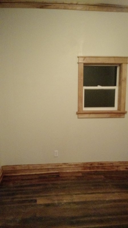

Starting to come together now. Here's my take on Craftsman style trim. I wanted to keep it simple yet give it a little more. So I did quarter round on the shoe and top caps 1/2 rounds on the mullets and lower caps.
Here is the general idea for the Craftsman style trim. I just jazzed it up a bit. I'm very happy with how it's turning out and it's very easy to make in my shop and install.
I also plan on doing the plate rail all the way around the kitchen but not for plates but canning jars.

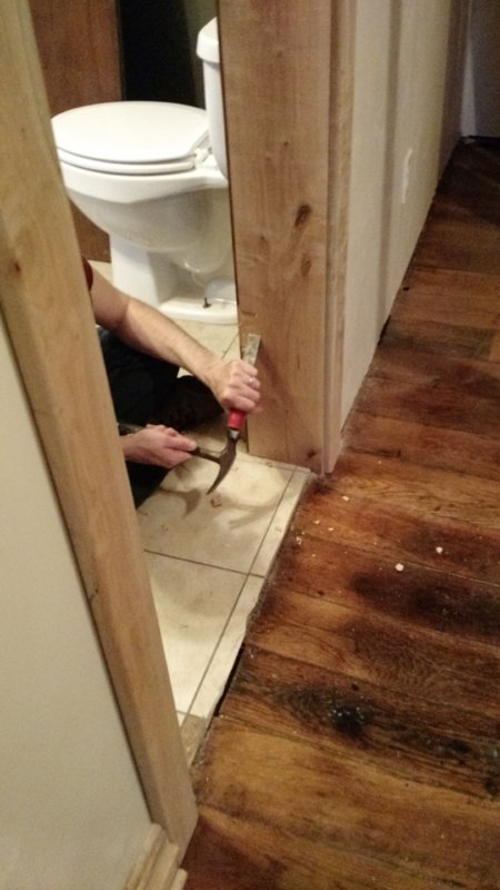

Son cutting out for door hinges. They don't call hard maple rock maple for no reason it is very hard to work. You can see the 5 piece base trim profile lower left.

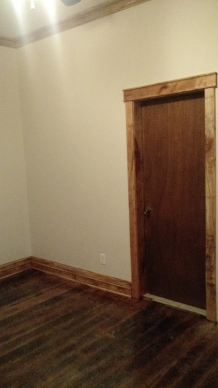

Some finished (ceiling, door, base)
Still lots left to do but I have most of the trim made up already, just needs to be cut, nailed in place and finished.
