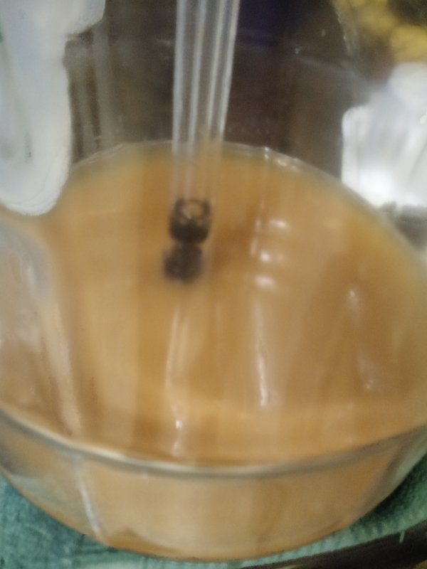

Here's the mess in the bottom of the carboy. More yeast for the septic tank.

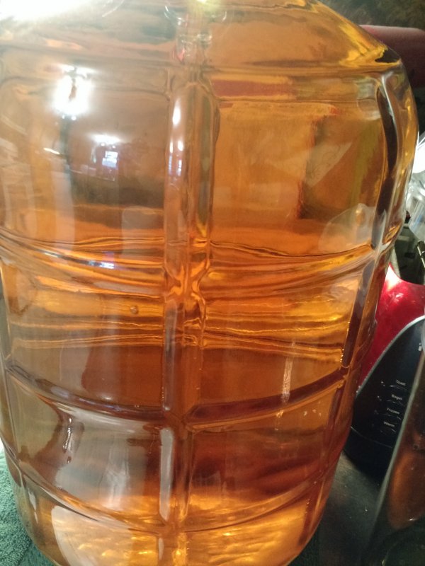

Here's what it looks like racked into a clean 5 gallon carboy, with benonite mixed in. It should drop somewhat clear in a few days to a week.

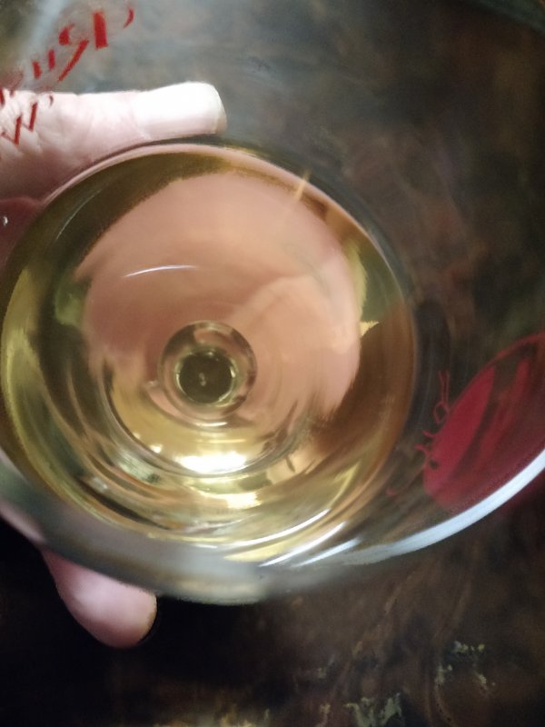

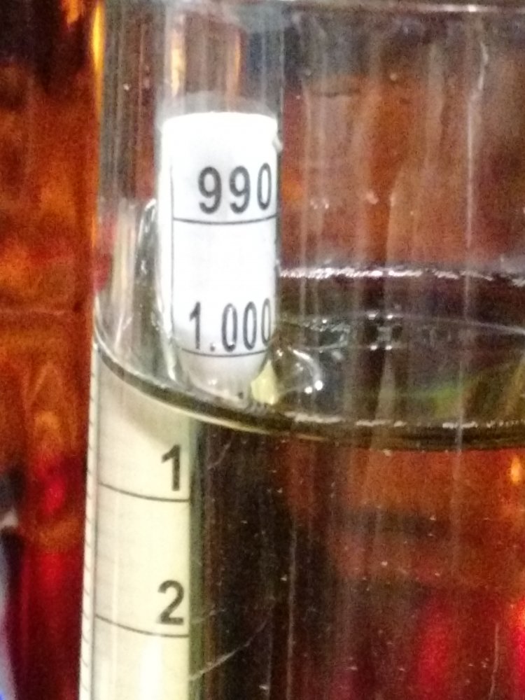

Sniffing notes... You can most definitely tell it's pear cider wine. It has a delightful pear and alcohol arroma. Tasting notes, it's totally dry at .990 gravity, there is no sugar left and you can tell because, it'll pucker your lips. I'll back sweeten at bottling time.
Here is what this wine looked like in a wine glass at the time of racking. It's pretty clear already but sparkolloid will make it very clear.
Here is what I I left in the bottom of the carboy that settled out from treatment with bentonite. It's just about 1/2 gallon that I poured into a 1/2 gallon Mason jar to cold crash in the refrigerator.

Here is what the pear cider wine looked like sitting with sparkolloid mixed in for one week. About the 3rd and 5th day twist the carboy back and forth quickly. This causes the sparkolloid that's sticking to the glass carboy to drop to the bottom. You can see the trub and sparkolloid in the bottom of the carboy.
Carefully rack into a clean and sterile carboy and degas. I also back sweetened to 1.000 with table sugar, 1.000 is the same sweetness as water. I like it exactly as it is.

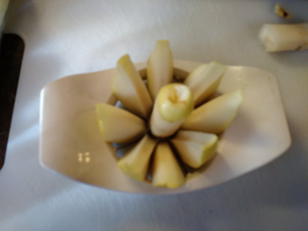

The first step is to prepare your pears.
Wash and de-stem them. Then core and chop them into chunks, you want no seeds or core what so ever, but chicken don't mind the cores. Be sure to leave the skins on.

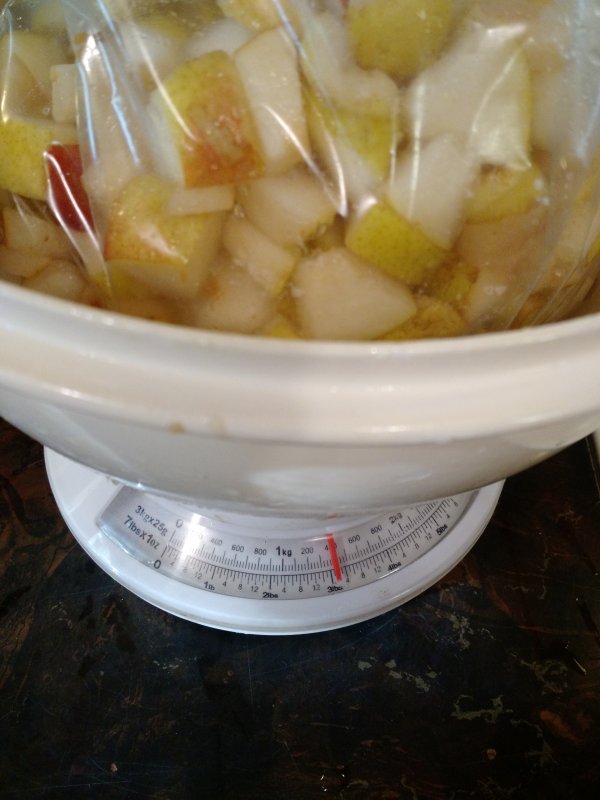

Place the chunks in a plastic baggie and weigh them. You'll need at least 3lbs
Next, crush the chucks in the baggie, then seal the baggie and place in the deep freezer to freeze up solid (overnight). Freezing fruit causes the pulp to rupture releasing juice, which making it easier for the pectic enzyme to break down and the yeast to devour and convert into alcohol and other tasty compounds.

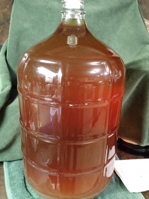

Well the time to bottle has came. I'll be bottling it tomorrow. It's been bulk aging since December 28 2019 (141 days). I'll post more tomorrow but looking back at the previous post it's definitely matured some. Kind of interested to give it a sniffer and taste test.

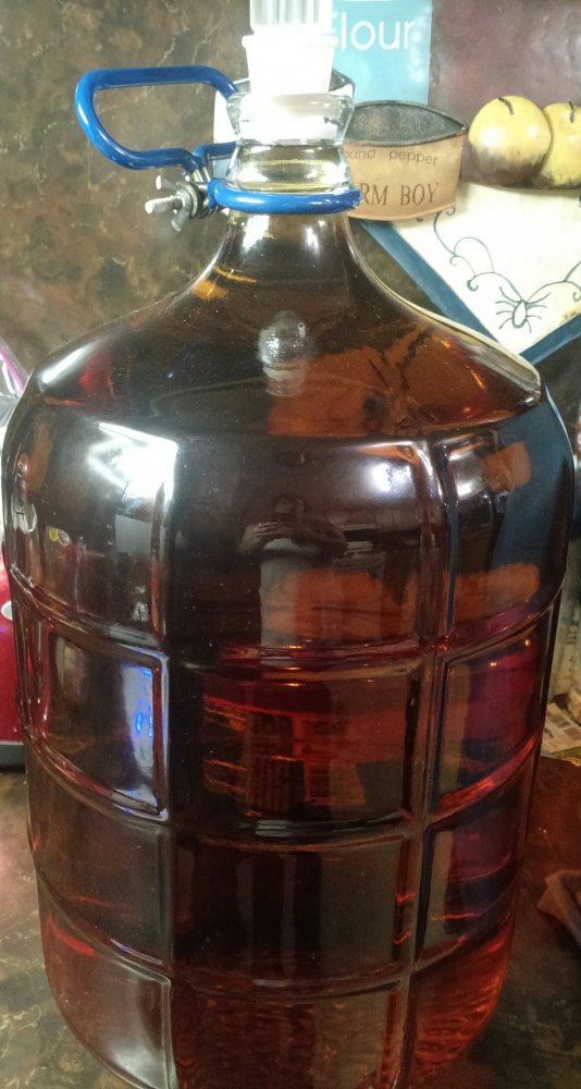

Picture of the plum full 5 gallon carboy waiting to be racked and bottled. It's crystal clear but has most definitely got darker. It's some high octane cider wine @ 15.6% ABV. I'm pretty sure it will take you where you need to go.
