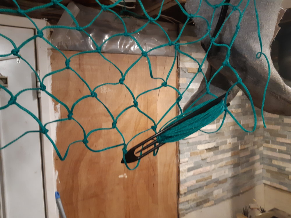

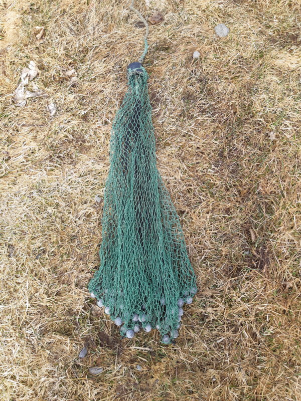

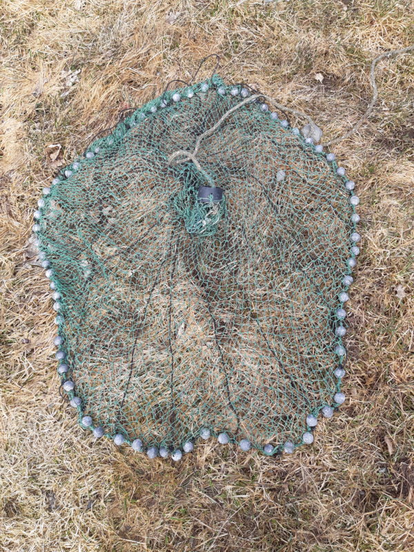

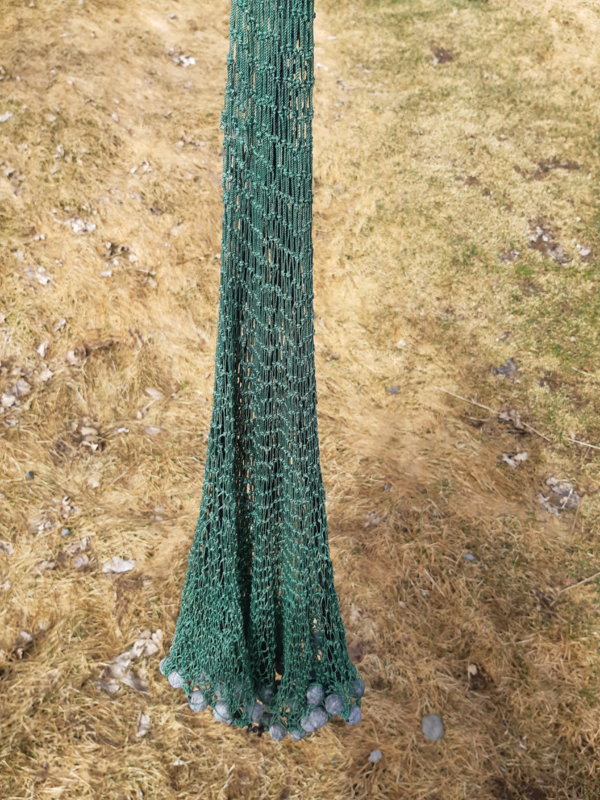

I am very happy with my cast net. I have made a few more since. 20190423_100221.jpg 20190423_100231.jpg 20190423_100253.jpg
I cant find the video I used but this one is not bad.
I tie my knot differently than in the video. This probably wont make sense till you watch the video but when making the net loops you will have 3 lines of twine meet at your mesh gauge. Everything I do is the same as what he does only I add an extra step. When he brings the needle under the right 2 lines he pulls it tight to make the knot. I don't. For my knot once you go under the 2 lines I go around again and put the needle under the first line only then pull tight. The reason I do this is I find that when you only go under the 3 lines the knot can sometimes. I believe the knot he makes is called the sheep bend by adding the extra step it becomes a double sheep bend

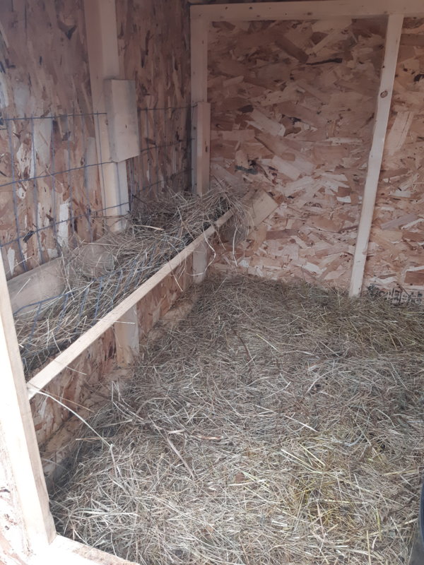

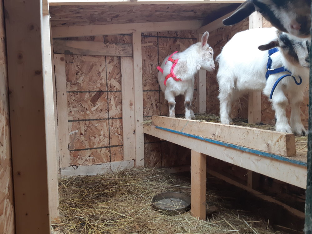

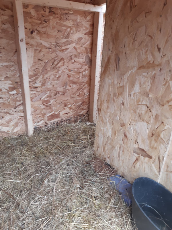

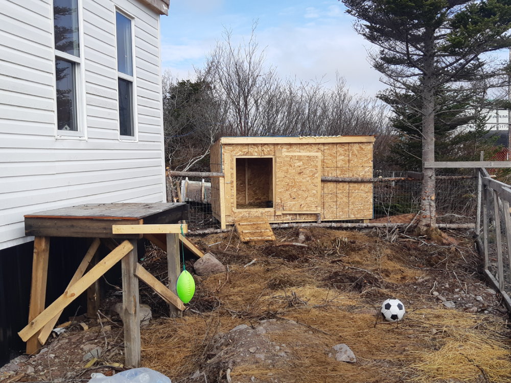

Some pics of the pygmy goats house. It still needs siding and tin on the roof. Which will be done once the weather cooperates freezing rain yesterday and today with the same expected for tomorrow.
Hay feeder on left side once you go in
Right side of door is there water, salt and mineral block and a half wall which provides a wind break to their sleeping area
And behind the half wall is a shelf they sleep on and on the far wall is another door to give me easy access for cleaning
